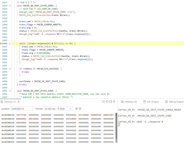

Background: We are implement SDIO base on MMCSD module. And we send CMD52 reset command and CMD5 command firstly.
Question: We can't get response value even if CSL_MMC_RSP10 has value. You can see below picture for more detail.
The value of CSL_MMC_RSP10 (0x48300210) is 0x30FFFF00 and the value of trans.response[0] is 0. You can see two values at Memory and CIO view respectively.
It will cause a response delay for all of our subsequent commands.
What can I do to fix this incorrect response order?
