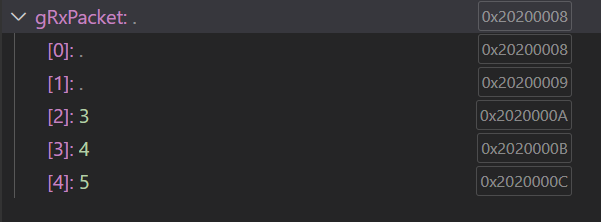

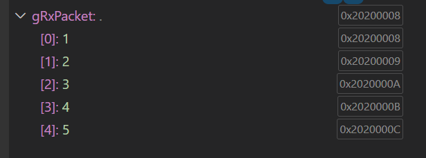

My goal is to create a read function that can be called by my application to read data from an IC. The example project shows how to setup the peripheral when only executing 1 read. When testing out the code, this seems to work fine. But when I move this into a function and call it within the infinite loop I begin to get weird behavior. The data is not being received correctly. For example, when I send the following characters ('12345') to the program, using the example project, I get:

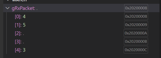

But, when I move the logic into a function and send the same characters, I get the following two instances. As you can see, the behavior is not as expected.

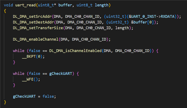

Below is a snip-it of the function.
So my question(s) are:
  • What is the correct sequence of events I need to do to be able to read data through UART without any issues?
  • Why is my data not appearing sequentially?
  • If I am expecting 5 bytes in my DMA and my rx trigger is set to "RX FIFO contains >= 1 entry", what is the sequence of events between the DMA and UART.

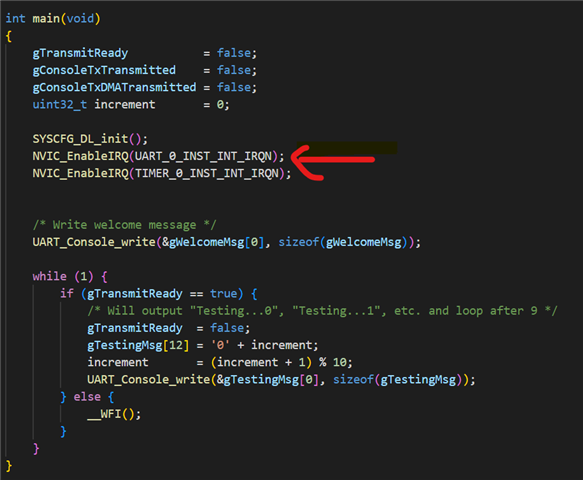

The example project makes sense since it already moves the UART write functionality into a function that can be called periodically by the application. I assume I can carry over this into my program without any issues. BUT the thing that I am unsure about is how this example code will behave when I introduce the ability to read data. Let me explain.
In the example program, the UART interrupts are enabled BEFORE configuring the DMA (src, dest, size, etc) and it is kept enabled throughout the lifetime of the program. Whereas in the read example the interrupts are enabled AFTER configuring the DMA.
TX example program
RX example program
I'm not sure when the UART interrupts need to be enabled and if it is enabled before/after (depending on write or read), I am going to run into any issues.

  • Looking at the symptom, my first guess is that you're getting an overrun due to some combination of (a) tx_console sending more than just your "12345" string and (b) your uart_read function doesn't happen to be active when the other end (tx_console) sends something.
    In most applications, data (Rx) arrival is unpredictable, so it's usual to keep the receiver active all the time and dole out the data to the rest of the program as needed. tx_console is designed to send a burst periodically (1/sec according to the .syscfg), but you're only sometimes listening; without coordination between the two ends the RX FIFO could overrun while your program isn't looking.
    How you do that coordination depends on what you (ultimately) want to do with this. It looks as though you have the UART+DMA mechanics about right; now you're into system design.

  • Hi Adan,
    For UART RX with DMA, the DMA should be enabled before the RXDATA received, and after finish the RX task, the next RX DMA should be enabled to wait for data.
    I recommend you add the enable next DMA transfer for RX into the DMA done interrupt with RX, so that it can timely enable and wait for next RX data.
    The DMA done on RX interrupt and UART interrupt should be always enabled.
    B.R.
    Sal
