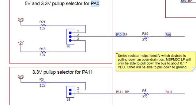

       I'm working with MSPM0C1104 microcontroller using CCS ver 20 . I'm trying to generate 1Khz frequency using Beeper  through the pin PA0 . I have done the Beeper setting using the configurator in CCS and I loaded the generated code  to my launchpad the Beeper pulse generates correctly through PA0 , then I changed the package Vssop - 20 to SOT-8  using the configurator and load the generated  code to the custom board ( custom board is powered through  Launchpad )  and now the Beeper frequency is not generating ( no waves are coming out  from PA0 pin ).

    I downloaded your project and flashed it to a LaunchPad and it seems to work as intended. Is it possible for you to share the schematic of your custom board? If necessary, you can also send it to msp-sbd-review@list.ti.com. This will also allow anyone on the MSP team to review the schematic, as well.

    Thanks for the reply. i don't have schematic i just bought a sot-8 to dip-8 pcb adaptor board , i'm powering  the microcontroller with 3.3v power supply unit . That it .  Is the PA0 pin open drain pin should i add a pull up resistor as like as in the launchpad to generate the buzzer pulses
  • Hi Yuvaraj,
    Yes, PA0 is an open drain pin and needs a pull-up resistor in order to drive a signal. This is most likely why you aren't observing a signal on the pin.
