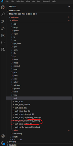

    Please look at the example below and this polling means we are not enabling UART interrupts and not the blocking mode.
    Blocking Mode means different. Block mode means we enable an interrupt for the UART and the UART driver will transfer the bytes, and it will wait for the semaphore signal. Then the task will be blocked until the semaphore signal. Once the signal is received from the ISR routine, the task is resumed.
    So, blocking mode and polling modes are different.
    C:\ti\mcu_plus_sdk_am64x_11_00_00_15\examples\drivers\uart\uart_echo_low_latency_polling
