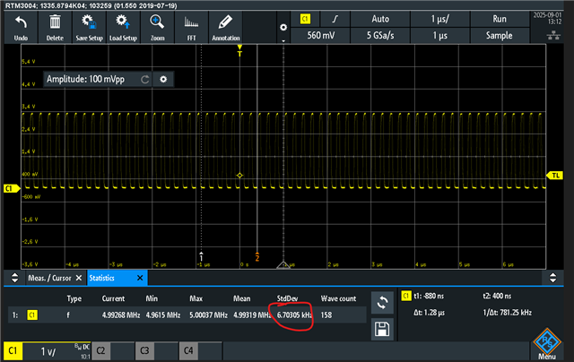

we have integrated the MSPM0G3507-Q1 for a custom design. We added a 24 MHz external Crystal (load capacitance 8 pF --> we use 12 pF capacitance on XTAL). We verified the crystal with the scope and its in the specified tolerance range.
We got some samples and flashed these with our SW. Our SW creates a simple PWM Timer with a clock of 5 MHz. If the PCB gets hotter then the clock gets more instable (PLL active), the timer clock fluctuates around some khz and thats not in the tolerance range.

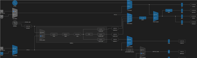

Originally Clock tree configuration

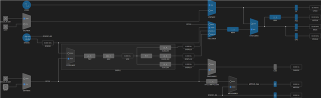

Only usage of internal Clock SOSC with this Clock tree configuration
--> 4 MHz clock output stable

External 24 MHz Crystal with PLL (original clock tree)--> 5MHz clock outptut not stable

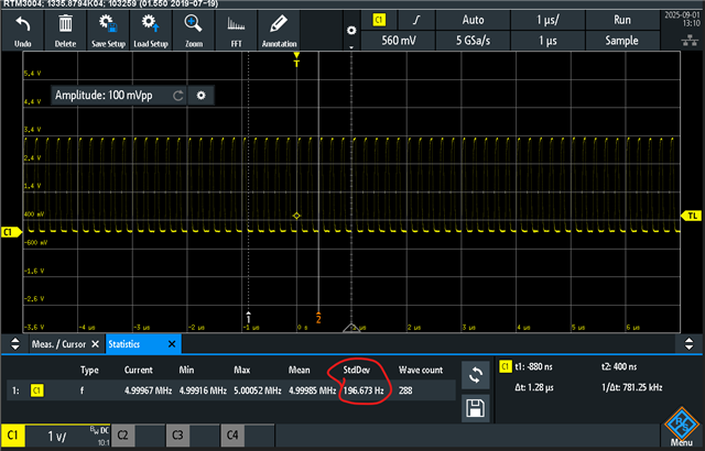

Picture from scope (std deviation >6 kHz increases until 30 kHz)
If i reduce enlarge the clk2x_Div from 6 to 8 --> CPU_CLK has
60 MHz instead of 80 MHz --> output clock of timer (5 MHz) is also stable!
scope picture (std deviation <200 Hz)
So it seems that there is a problem with PLL configuration.
In SYSCTL "Enable Check for Clock Stabilization" is always on. We use CCS 20.0 but it doesn't matter which version we use. We have also samples where we have no problems with the 80 MHz output PLL configuration.
We are not sure if some of our MCUs has a temperature problem, a soldering problem is not visible. Sometimes we change the IC and then it works with the original configuration. Is there any known problem with PLL config or clock config or timer config, which can cause a unstable clock with a temperature increase (any prescaling settings or something else)?

  • We have tested approximately 20 PCBs with the same software, and in about 30% of them, the generated timer clock is unstable. We would rule out a manufacturing problem for the time being.
    I made your suggested tests and i did not saw a difference between SYSPLL0 an SYSPLL2X. If I reduce the CPU Clock to 40 MHz the deviation is a bit better.
    I have created a very simple piece of software that only initialises a timer and generates a 2.66 MHz clock. I am using the external crystal, and measured the frequency of it which appears to be very stable.
    The behaviour is not always the same. Sometimes the clock frequency is very unstable, up to 10 kHz deviation, and sometimes it is a few hundred hertz. It seems to me that sometimes the initialisation of the PLL does not work, which causes the deviation. Is there any SDK version or CCS version where the driver library has changed and such behaviour can occur? I use MSPM SDK Version 2.5.1 and CCS 20.0 and I also used it with SDK version 2.3.7. I had the same problem.
    Re-check your scope result, since std is vey large, do you have jitter test result from oscilloscope?
    Trigger at rising edge of PWM and capture the falling edge or next rising edge, enable the image retention function.
    To see how large the jitter is.

    The deviation is very high and out of spec:

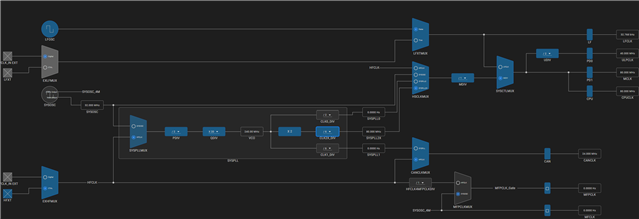

    This is the clock tree with 80 MHz MCLK:
    These are the timer settings:
    This is the very unstable timer output:
    Sometimes it is still higher or lower:
    If you capture some minutes there are also time periods where the deviation is very low some 100 hertz.

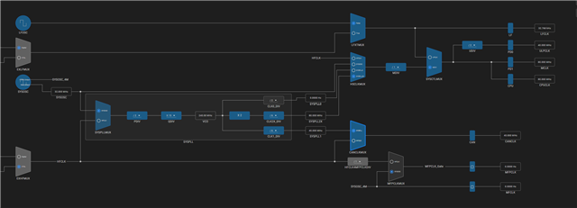

    If I only set the CLK2X_DIV from 6 to 8 MCLK has 60 MHZ and I have no problems, see following picture
    Here we have no problem we have just a deviation of about 360 Hz. The frequency in this picture is lower because the timer setting are as before but the MCLK has still 60 MHz.

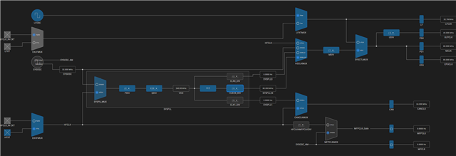

  • So if I hold VCO below 160 with external Crystal the CLK is stable. If it is above 160 the clock ist unstable. Is there a recommendation in the datasheet or somewhere else to hold VCO below 160 MHZ?
  • In datasheet you can see a limit of 400 MHz
  • Thanks for your feedback.
    Referring to the previous talk, if VCO is 160MHz, PLL is unstable. Could you please double check this test point?
    Now, datasheet limit VCO between 80 ~ 400Mhz, but still recommend customer to use a 8/16/32MHz external HFXT and set VCO to 160MHz.
  • Okay but this customer recommendation is still not written in any document? With the internal oscillator clock is stable with VCO=160 MHz. With an external crystal of 24 MHz it is not possible to reach VCO=160 Mhz with the divider settings. If we are above 160 MHz it is getting more and more unstable, below it is stable. So we are thinking about to change the crystal to 16 MHz then we can make a VCO setting to 160 MHz to reach a CANCLK of 80 or 40 MHz. This is important for us. So do you recommend to stay below 160 MHz with an external Crystal or is 160 MHz also okay?

  • "In earlier reply, I have ask the result of VCO = 160MHz, this is why I want to double confirm with you whether VCO=160MHz works or not.
    Can you double check this point?"
    Yes, I checked this, it works!

    No, first seen this.
    The reason why recommend customer using VCO=160MHz, is this is the test frequency point of some specs in datasheet 7.9.3 System Phase Lock Loop (SYSPLL).
