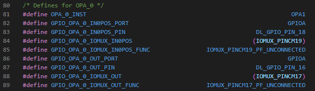

  • also note that if I simply add both OPAs to the syscfg, it will compile successfully. I will continue to try to parse this bug for TI.
  • Hi Roger,
    Thanks for providing the information. I will look into this and get back to you as soon as possible.
    Owen
  • working with OPA0 for the moment - the compile error appears to arrive when i try to assign the inverting input to the IN0- pin.
    it compiles ok, with the output assigned to a pin(25), and the non-inverting input assigned to its I/O pin (28).
  • OPA1 - has the same behavior, when trying to assign the inverting input to the input pin, the gmake error occurs.

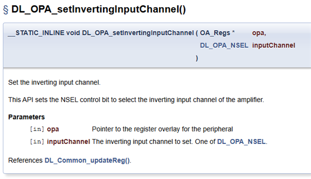

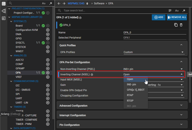

    In the meantime, here is a workaround I would suggest:
    Configure the OPA as you had done previously, but in the Inverting Channel (NSEL) field, choose another option, like Open.
    Then at the beginning of Main, you can use DL_OPA_setInvertingInputChannel() to change the NSEL from Open to IN0-.

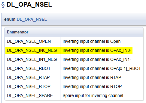

    The opa parameter can be found in the ti_msp_dl_config.h file and depends on what you named it in SysConfig:
    By default, it is OPA_0_INST.
    For the inputChannel parameter, set it to DL_OPA_NSEL_IN0_NEG.
    Owen

  • it certainly compiled. Thanks SOOO much. Onward.

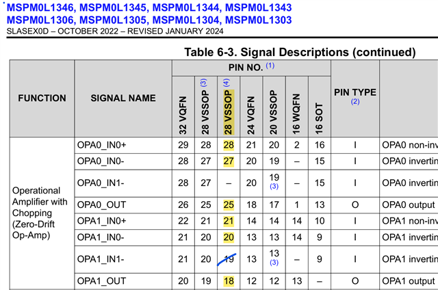

    There appears to be a problem with the pin associated with the OPA1 output - sysconfig has it as 19, datasheet shows it as 18.
    I can close this issue out, and will create separate.

    I see that in the datasheet OPA1_OUT is pin number 19:
    And in SysConfig it seems to be correct:
    Do you see something else?
    Owen

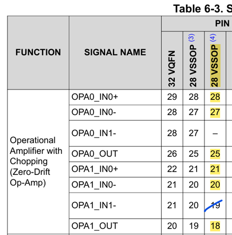

  • indeed, revision D January 2024, Table 6-1 does show it as 19!
    However, unexplained Table 6-3 shows it as 18. Error?
    But for me, I only need to be assured it is actually 19. which syscfg is using...
  • Hi Roger,
    Thanks for sharing. It does seem like there might be a typo in Table 6-1. I reached out to the team that works on this document to hopefully have it fixed as soon as possible.
    As for the OPA1_OUT pin, it should be pin 19.
    Owen
  • thanks, my preference is to use Table 6-3, so thank those on the Teams for that bit of publishing.
    will update schematics, and proto accordingly... Best,
