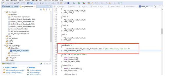

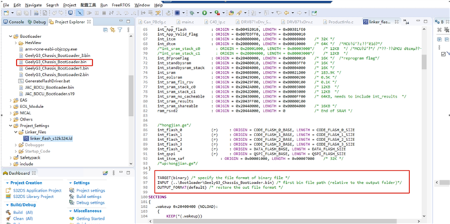

My customer have a lot of files that need to be placed in different memory space, and they want to use cmd file to combine other file(bin or txt or hex) to one file, like below:
