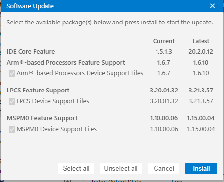

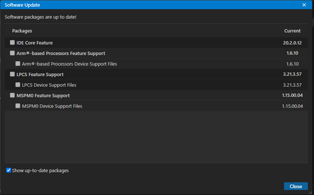

  • In CCS Theia: File → Preferences → Open Code Composer Studio Settings → Products, added C:\ti to Product discovery path, then Refresh.
    → CCS Theia shows MSPM0 SDK 2.5.1.00 in “Discovered products”.
Is there an additional device support package I need to install for MSPM0C1106 in CCS Theia?
Please let me know if any additional information would be helpful; I can provide IDE logs, screenshots (Products and the error dialog), and the exact example path I tried.
