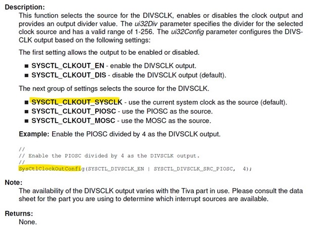

  • Dear Charles Tsai,
             Thank you for your response.
    To provide some context regarding our application — our custom board includes an MSP432E4 microcontroller, an Artix-7 FPGA, and an RFIC. We are currently working on implementing QPSK modulation, which requires a 40 MHz clock input to the FPGA.
    As part of our exploration, we were evaluating whether it's possible to generate this 40 MHz clock using the PWM capabilities of the MSP432E4. I understand from your response that such a frequency may not be feasible via PWM, even though the datasheet doesn’t explicitly mention the maximum PWM frequency.
    We also attempted to use an external 40 MHz crystal oscillator to meet the FPGA's clock requirements, but unfortunately, it didn’t perform as expected in our current setup. This is why I initially raised the ticket — to confirm whether any alternate method of generating a 40 MHz signal from the microcontroller is possible or officially supported.
    If you could share any suggestions or alternate approaches for generating a stable 40 MHz clock (either from the MSP432E4 or other feasible methods), it would greatly help us determine the best path forward.
    Looking forward to your valuable input.
  • The MCU can output a clock through the DIVSCLK pin. However, I/O is not designed for high frequency. You will see noises and distorted signal shape at high frequency like 40Mhz. I don't know if that is suitable for your FPGA.
