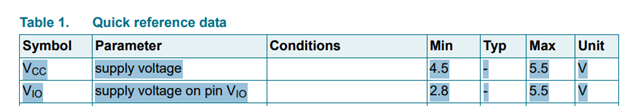

It appears that the TJA1051T/3 is not compatible with MSPM0’s 3.3V logic levels (TXD and RXD).

    1. I checked on the datasheet of TJA1051T/3. It seems that it supports VIO as 3V. So, in the application level, you need to provide VCC as 5V and Vio as 3.3V for TJA1051T/3.
    2, 3 and 4. TCAN114x, TCAN1046 EVM and etc.. As long as the Vio supports 3V.
    5. We will check it and give you feedback later.
