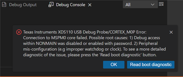

I am currently using the latest version of Code Composer Studio (CCS) IDE. However, whenever I try to start a debug session for my project, I encounter the attached error message. when I was working with an older version of CCS using the exact same project and setup, I did not face this issue — the project built and debugged successfully without any errors.

  • Hello Helic,
    I have tried all of the steps mentioned above, but unfortunately it is still not working for me. I am following the exact same procedure that I used earlier, when it was working correctly on our hardware. Interestingly, I have another project that runs without any issues on the same hardware using the updated IDE. However, my older projects are showing the error that I shared with you.

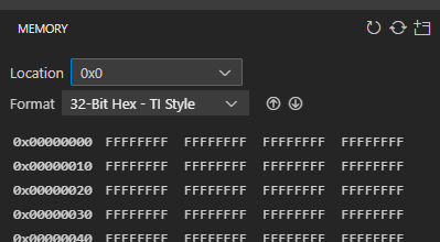

  • I check your firmware, 0x0 data is 0xF
    And in your linker file, you set all code start from 0x4000.
    But Arm cortex M0+ core keep start CPU from 0x0.
    .intvecs:   > 0x00000000
    At least, you need put your int vector start from 0x0, make sure CPU can jump to app starting from 0x4000, Or you need add a boot start from 0x0 to do the CPU jump function, and then you can keep app start from 0x4000.

  • you need recovery your device first, because of the existing invalid firmware in MSPM0
    Do factory reset in BSL mode.
    If common steps is not workable, please try to repower the MSPM0, and keep PA18 high, MSPM0 will enter BSL mode.
    Then try to connect MSPM0 DPA port in CCS target configuration. (Show all cores – connect DAP).
    DAP connect: right click MSPM0G3507.ccxml file in CCS project, start project-less debug, there will factory selection in Menu - Script
    Please refer to my modification:
    MEMORY
        FLASH_INTVCT    (RX)  : origin = 0x00000000, length = 0x00000400
        FLASH           (RX)  : origin = APP_START, length = 0x00020000 - APP_START
        SRAM            (RWX) : origin = 0x20200000, length = 0x00008000 - 0x8
        SHARED_RAM      (RW)  : origin = 0x20207FF8, length = 0x8
        BCR_CONFIG      (R)   : origin = 0x41C00000, length = 0x00000080
        BSL_CONFIG      (R)   : origin = 0x41C00100, length = 0x00000080
    SECTIONS
