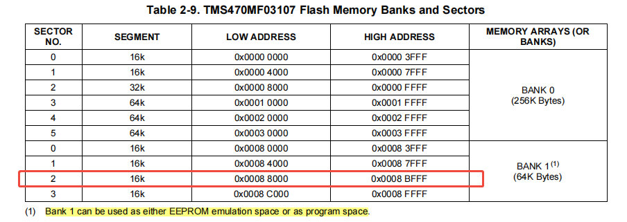

  • hi thanks for reply!
    You mention:
    That is correct. After an erase, all bits should be 1's. What do you mean by sometimes? Are you using the Flash API to erase or are you using the CCS or Uniflash Flash erase to erase all flash banks through JTAG? Are you saying it will erase successfully sometimes but not all the times?
    We program the .hex file into the chip flash using CCS or Uniflash after erasing all . And then during the customer using period,the program use the FLASH API to erase and write the target sector of the EEPROM region of BANK1 indicated  in the picture above. When we aim to write some non-zero data into the target sector,after ignition off and on operation, the data read back indicate all 0s,which is not expected.
             We want to know the potential root cause of this unexpected phenomenon.  thanks!
      Can you show me which API you use to program the target sector?
      Are you programming the sector as a regular flash or as an emulated EEprom?
      What was the content of the target sector before you call the API? Was it all 1's to begin with?
      Do you see the problem on one device or all the devices you have?
  • Hi ,
         you mention:
          "Can you show me which API you use to program the target sector?"
          In the application program,We use Flash_Erase_B() to erase,and use Flash_Prog_B() to program.
          "Are you programming the sector as a regular flash or as an emulated EEprom? "
          As an emulated EEPROM;
          "What was the content of the target sector before you call the API? Was it all 1's to begin with?"
          It all depends.It's strange,do you know why?
           " Do you see the problem on one device or all the devices you have?"
           This problem is raised by the probability of 40% or so among the devices .
    I don't think you are using the flash bank 1 as an emulated EEprom memory. You would have needed to use a FEE driver to emulate a regular flash memory as a EEprom. Please refer to the TMS470M FEE driver https://www.ti.com/tool/download/TMS470MFEE for details.
