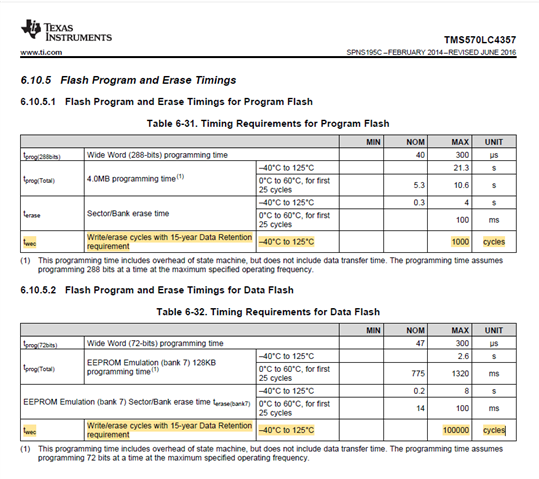

Part Number: TMS570LC4357-EP
What is the minimum data retention on the non-volatile memory for this device.
Thank you
Mike
