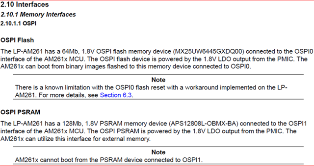

Champs:
This doc mentioned we have the PSRAM on the AM2612 EVM?
Is this true?
I cannot find the PS ram on the BOM / schematic, please explain.

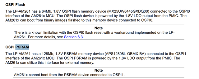

Hi Rio,
The PSRAM present on the AM261x-Lp is from AP memory
APS6408L- OBMX-BA
APS6408L-3- OBMX-BA
This is alreday captured in LP-Am261x user guide:
https://www.ti.com/lit/ug/sprujf1a/sprujf1a.pdf?ts=1751475538278

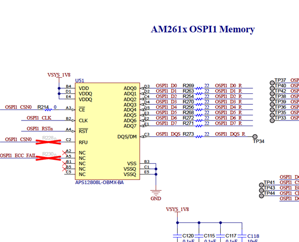

Hi Anand:
Sorry, the point is: We have checked the schematic / BOM of the LP EVM.
There is no PSRAM on those 2, so, cust is asking why we put the PSRAM for this.
BR Rio
Hi Rio,
Not sure which schematic file you have looked at, the second revision of AM261x-LP(E2) has PSRAM on the second OSPI interface. It is mentioned in the schematics.
