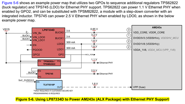

  • If you check the app note you wrote, Using LP8733xx and TPS65218xx PMICs to Power AM64x and AM243x Sitara Processors
    If you're using the AM2431 ALX package + Ethernet (Figure 5-6), the LP87334D is recommended.
    (Our product uses the AM2431 + Ethernet (DP83869))

    The AM243_ALX only requires 3-4 supplies (CORE, 3.3V IO, 1.8V IO and VDDA_1V8). Any other supply in the EVM is application dependent and not necessarily required by the MCU. The power supply implementation of this MCU is simple enough for easy implementation with discrete or PMIC. If you don't feel comfortable with the power supply design process I would recommend re-using the validated power solution from the LP-AM243 EVM.
    However, if you proceed with the PMIC, here are some notes to assist the design process. Let us know if there are any questions.
    • LP87334D comes pre-programmed to meet the voltage/current/sequence requirements of the AM243_ALX MCU. Customers are responsible for performing a system level power analysis to make sure the 3.3V and 1.8V IO supplies (i.e LP87334D BUCK1 and LDO0) have enough current rating to supply the MCU and peripherals which are specific to your application.
    • If you are planning to use the EthernetPHY in a two-supply configuration and driving the VDDIO with 3.3V as implemented in LP-AM243 EVM, then there shouldn't be any issues with the PMIC current rating. Here is a high level supply diagram that you could consider. Please refer to EthernetPHY datasheet for information about two-supply configuration and sequencing requirements).
    Brenda

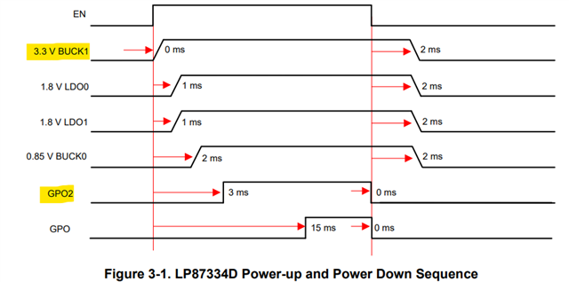

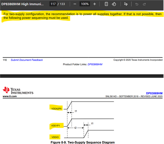

    As I mentioned above, I'm planning to build a product using the LP87334D (0.85V, 1.8V, 3.3V), AM2431 (ALX package), TPS62822 (1.1V), TPS745 (2.5V), TLV75518 (VPP_1.8V), and DP83869 (Ethernet).
    Do I need a 3.3V power switch for this configuration? Or can I just connect the buck output directly to the VDDIO of the DP83869?
    Please confirm.
  • The sequence requirements of the EthernetPHY can be found in the DP83869 datasheet (see capture below). It requires powering all supplies together or supplying VDDIO after the 2.5V/1.1V rails. The LP87334D was configured to turn-ON BUCK1 (3.3V) first in sequence (see second capture below). If you are enabling the external 2.5V/1.1V rails with the PMIC GPO2, then the next step in the design process would be controlling the enable of the VDDIO. How do you make sure VDDIO turns-ON at the same time or after the 2.5V/1.1V rails? One option would be using a power switch instead of connecting the PMIC Buck1 directly to DP83869.
    From DP83869 datasheet
    From LP87334D Technical Reference Manual
    Brenda
