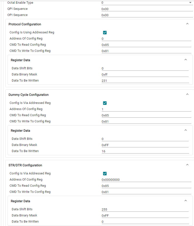

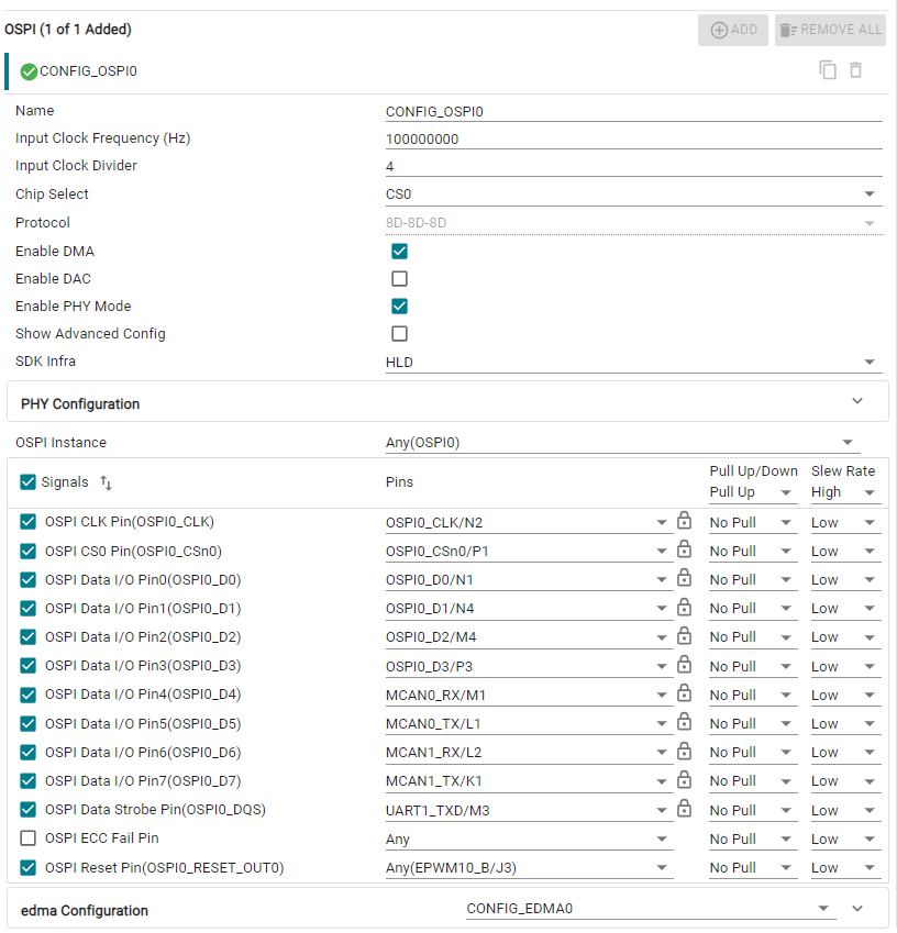

As per documentation on TI officials:- https://software-dl.ti.com/mcu-plus-sdk/esd/AM243X/latest/exports/docs/api_guide_am243x/EXAMPLES_DRIVERS_OSPI_FLASH_DIAG.html, I run the diagnose example on AM2432 and read SFDP Parameters from OSPI Flash memory (IS25WX064). I got success in reading SFDP Parameters but getting issue during configuration for OSPI Read/Write.
For OSPI Flash read/Write, I considered (ospi_flash_io) example code from TI - https://software-dl.ti.com/mcu-plus-sdk/esd/AM64X/08_00_00_21/exports/docs/api_guide_am64x/EXAMPLES_DRIVERS_OSPI_FLASH_IO.html ; However, during debugging, the code stuck at driver_open API.
I believe that there might the issue with configurations of Flash memory or OSPI. I am going to share SFDP Parameters and sysConfig data. Let me know the possible causes and solution based on the data.

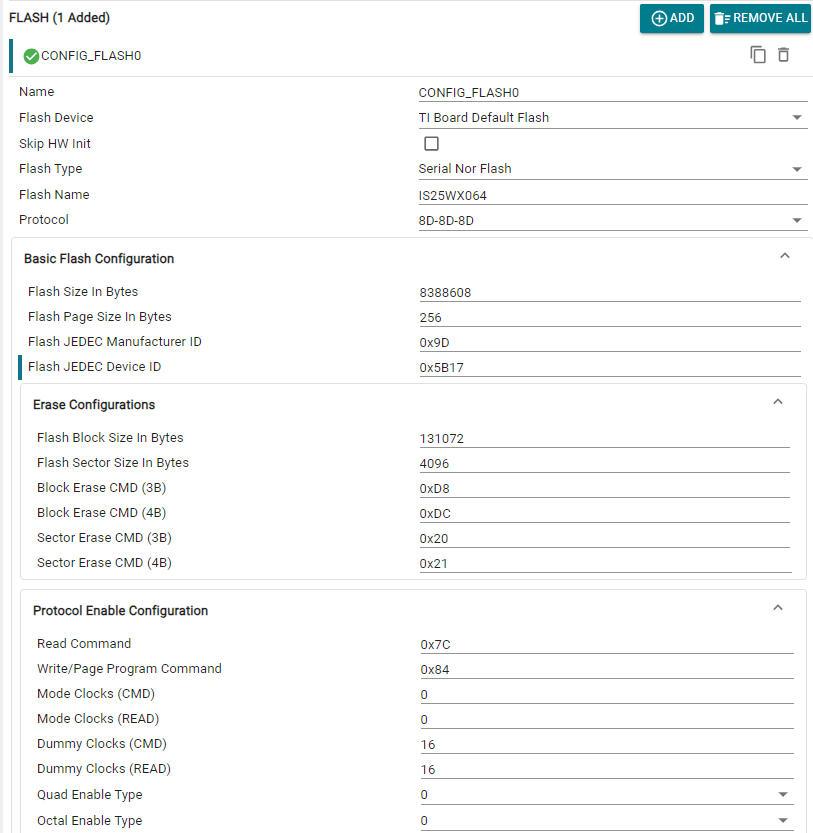

JSON Data for the flash :
"flashSize": 8388608,
"flashPageSize": 256,
"flashManfId": "0x9D",
"flashDeviceId": "0x5B17",
"flashBlockSize": 131072,
"flashSectorSize": 4096,
"cmdBlockErase3B": "0xD8",
"cmdBlockErase4B": "0xDC",
"cmdSectorErase3B": "0x20",
"cmdSectorErase4B": "0x21",

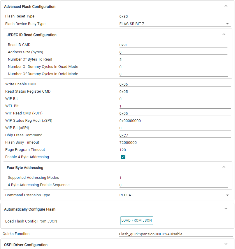

"pCustom": {
"fxn": null
"addrByteSupport": "1",
"fourByteAddrEnSeq": "0xA1",
"cmdExtType": "REPEAT",
"resetType": "0x30",
"deviceBusyType": "0",
"cmdWren": "0x06",
"cmdRdsr": "0x05",
"srWip":  0,
"srWel":  1,
"cmdChipErase": "0xC7",
"rdIdSettings": {
"cmd": "0x9F",
"numBytes": 5,
"dummy4": 0,
"dummy8": 0
"xspiWipRdCmd": "0x00",
"xspiWipReg": "0x00000000",
"xspiWipBit": 0,
"flashDeviceBusyTimeout": 20000000,
"flashPageProgTimeout": 120
SYSCONFIG Script:
In SFDP Parameters -> Protocol Configuration parameters are all NULL. This might create the issue.
"protoCfg": {
"isAddrReg": false,
"cmdRegRd": "0x00",
"cmdRegWr": "0x00",
"cfgReg": "0x00000000",
"shift": 0,
"mask": "0x00",
"bitP": 0
Please check that SFDP parameters are correct or I need to modify it.
