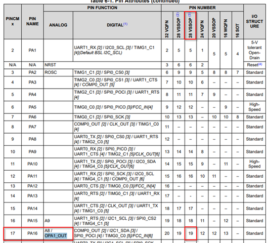

Part Number: MSPM0L1345

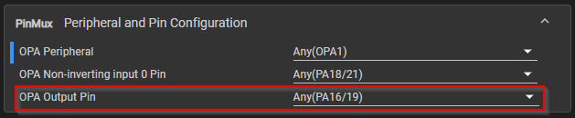

It would appear to me that there is a issue of which pin the OPA1 comes out on.
OPA1 output - sysconfig uses pin 19, datasheet shows it as 18.
Hi Roger,
It does seem like there might be a typo in Table 6-1. I reached out to the team that works on this document to hopefully have it fixed as soon as possible.
As for the OPA1_OUT pin, it should be pin 19.
Owen
