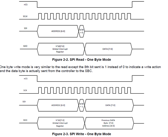

Currently the device will send the 7 bit address + r/w bit and then raise the nCS pin high before bringing it back low to send the 8-bit transaction or receive the 8-bit message.
The SBC expects nCS to be low for the entire trasaction - including address and data - like below:

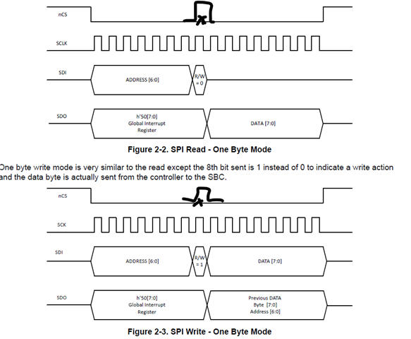

But the nCS pin on the MCU keeps doing this:
Where it pulls nCS high after every byte.
I believe there should be a way to fix this where the entire transaction has nCS low instead of going low for each byte. As with what is currently happening now is that the SPI bus on the SBC gets reset everytime the nCS pin goes high in the middle of a transition.

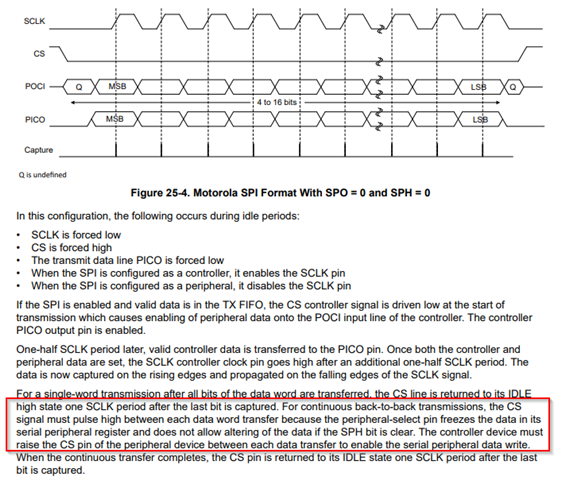

  • Short answer: I recommend using a GPIO for nCS. There's no reason you can't use the same pin you're using now with the built-in nCS. What difficulties did you have with this?
    Slightly longer answer: TRM (SLAU846B) Sec 19.2.3.1 describes how /CS functions in each of the SPI modes. In two of those modes, /CS will stay low as long as you maintain a "continuous back-to-back" transfer; based on context and history I interpret this as "the Tx FIFO (+ shift register) never empties".
    For a sufficiently fast SPI, this is difficult to guarantee using software. DMA will probably accomplish it, but even that has no guarantees (the DMA can get "distracted"). The consequence of not keeping up (as you're seeing) is having your transaction broken up into two, and you won't even know it happened.

  • Hi Parker,
    Show more details on Bruce introduction:
    This limits M0 as peripheral mode, I suppose you set M0 as controller, so this should not limit your controller behavior.
    Two method is introduced for it:
    1. Use SPH=1 mode, then the controller will NOT generate the CS pulse during the data frame.
    2. Disable the CS function, and use GPIO to act it as you tried before, I think it should work without any issues. I used to try with this method.
