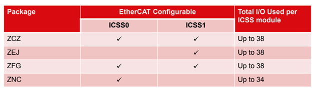

I want to check whether the ZNF package can support Ethercat with the 2x ports of MII. We have a working system currently on the AM2612 ZFG package, and are trying to understand the feasibility to move to the smaller ZNF package.
Using the latest sysconfig tool with the ZNC package and same map of PR0_PRU0_GPIOx and PR0_PRU1_GPIOy pins as we have been using with the ZFG package, it looks like it should work.
Can you confirm this?
