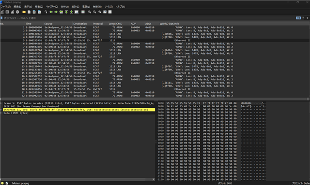

  • I've also attached the WireShark log from when it was unable to operate for 350ms.
    The first frame sent drift compensation (CMD:ARMW),
    the second frame sent LRW, and the third frame also sent LRW.
    This data was captured using profishark1G,
    and as you can see, the third frame was not captured correctly.
    (The profishark options Transmit CRC errors, KeepCRC32, and Capture full frames are enabled.)
    This may be something I should ask profitap about, but since a bug in the analyzer seems unlikely,
    I would like to first eliminate any possibilities, such as API usage issues.
    Are there any restrictions on using EnetDma_submitTxPktQ?
    For example, after sending, do I need to receive data before sending the next data?
    Addendum: I was unable to attach the packet capture from Wireshark, so I pasted the image.

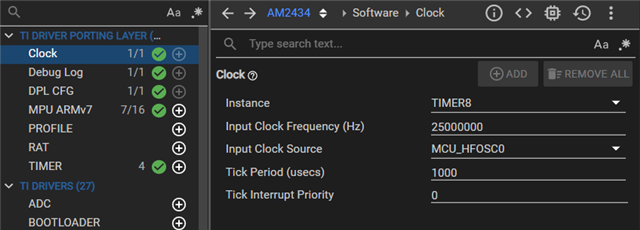

    The receiving task calls ClockP_usleep(1)
    The minimum time period for the ClockP_usleep is 1ms (1000 usec). Anything less than that will use a loop based call to finish the sleep task. This wouldn't give consistent results. If your application needs a precision of 1us, we suggest you to make use of timers instead.
    From the wireshark logs image, I cannot locate packets with 350ms difference. To share the pcap files, you can compress the capture file, and attach to the post. That will help us analyze the traffic better.

    I did a little research with a debug build here, and it seems like the tick isn't updated inside uint64_t ClockP_getTimeUsec(void),
    and there's a delay until it's updated.
    Do you know why this is occurring?

    From the capture, I am observing jumps of around 250us, but not 350ms as mentioned earlier. Can you please confirm this observation from your side as well?
    I was not able to test the behavior of the ClockP_usleep() api as of now. As you would have already seen in the code, The ClockP_usleep api wouldn't go into sleep, but rather spend time within the function for delays less than 1ms. Please let me profile the API in our test setup, and that will give some insights for where the issue is.
    I will keep this thread posted about the results. Please expect a response by end of this week.
    Thanks and regards,
    Teja.
  • From the capture, I am observing jumps of around 250us, but not 350ms as mentioned earlier. Can you please confirm this observation from your side as well?
    Thank you for confirming.
    Sorry, there was some information I didn't mention.
    Please pay attention to data numbers 501-1901 in the WireShark data.
    Even though they are EtherCAT frames, the return frame could not be captured.
    I believe this is the reason the receive task was unable to operate for 350 ms.

    The ClockP_getTimeUsec function also contains the following comment, which makes me wonder if there are any restrictions on setting priorities.
    /** Check if the timer has overflowed.
    * This is to handle cases in which this function is invoked from critical sections with
    * interrupts disabled, and hence `gClockCtrl.ticks` won't increment even in case of
    * overflow in the timer count.
    * When the ISR increments `gClockCtrl.ticks`, it will clear the overflow status. */
