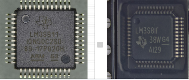

Hello, is there the LM3S811-IQN50-C2 have didererent marking code ? the datasheet shows LM3S811 IQN50 PT, but i got two marking code : LM3S811 IQN50 PT and LM3S811 38WG4 A129

Where did you purchase these materials from?

Hi Heidi,
These are not legit TI parts. We could not identify these two based on the code shown on the marking.
The one on the left has the TI logo on top. It should be below the part number.
The one on the right looks wrong since the TI logo is printed with stripes.
