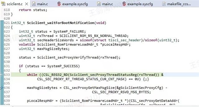

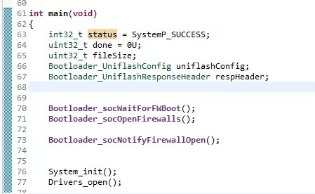

When use JTAG to debug find it will stop on the following code
Bootloader_socWaitForFWBoot()
Customer's flash project slb_uart_uniflash_am243x-evm_r5fss0-0

    Thanks for the question and the SysConfig file as discussed.
    I would not say that this is an OSPI controller issue as it is not even at Board_driversOpen where the Flash Init happens.
    This is happening before the call of Board_driversOpen is done.
    Please confirm if the Bootloader_socWaitForFWBoot() hang is seen in the file SBL UART Uniflash itself and not in SBL NULL?
    If seen in SBL UART Uniflash itself, then I can assign another expert to comment on this.

  • Vaibhav,
    We are identify the root cause that DDR hardware issue as there are some board work normally.
