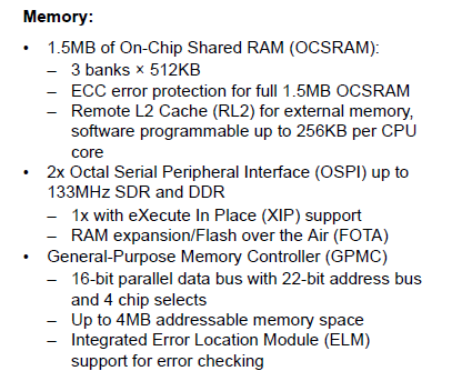

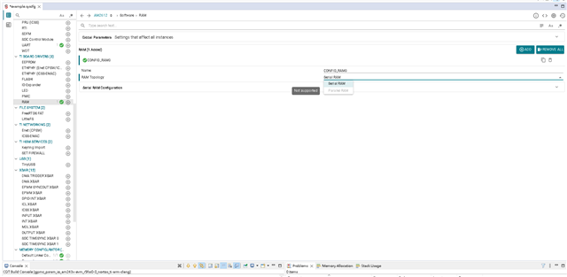

I have designed a new circuit board that uses GPMC to connect PSRAM, but it seems there is no support for it in SYSCONFIG?

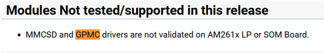

The GPMC driver is not available in SDK 10.2 . It will be added in the future release.
AM261x MCU+ SDK: Release Notes 10.02.00
