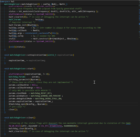

In general we could say that this is the code that is used for our watchdog:
The BFWatchdog_open is the same as the Watchdog_open, except it does not take an array index but the config itself.
We also use it as an fiq-interrupt, because we noticed a HwiP_disable also would block the watchdog-interrupt, which it shouldn't and nmi is not available that way on the am243x:

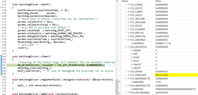

so, if we have a release-build already on the device, we come here:
WDSTATUS looks nice.

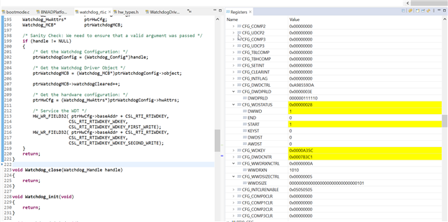

And now as soon as the Watchdog_clear is returning:
The WDSTATUS somehow gets set?
CCS does not use the v1-file, but the v0, that's why the line does not match the code on the left.
But we always experience that and that makes it impossible to debug a board which has a release-firmware already on it. So, a firmware which already initialized the Watchdog once.
Also our watchdog-period is set to 16 seconds! So it's not like I were in a breakpoint for too long or smth. it immediately occurs after start as soon as the Watchdog is created.

  • Hello Felix,
    In AM64x devices, the watchdog timer (WDT) can only be configured once after reset. Once you set the watchdog time-period, re-configuring it later will not overwrite the existing configuration.
    In your scenario:
    • If you already flashed an image that configured the WDT with period X, and then you load another image from CCS with a different period, the WDT peripheral will retain the first period and ignore the new configuration.
    • This is expected behaviour on AM64x — the WDT parameters are latched after the first configuration until the device is reset.
    Another important point: AM64x watchdog does not support auto-reset of the SoC. If we wanted to make soc Reset after the wdt is expired then we need to be integrated wdt with ESM module .
    • If the SoC is running in an exception state (for example, due to a fault), then even if the WDT expires, the interrupt will not be serviced, and no reset will be triggered.
    • This means the system can appear “stuck” if you rely only on the watchdog interrupt.
    To fix this, the recommendation is to configure the WDT with ESM to resets the SoC after expiry. This ensures that even if the CPU is stuck in an exception or cannot handle interrupts, the watchdog will still recover the system.
