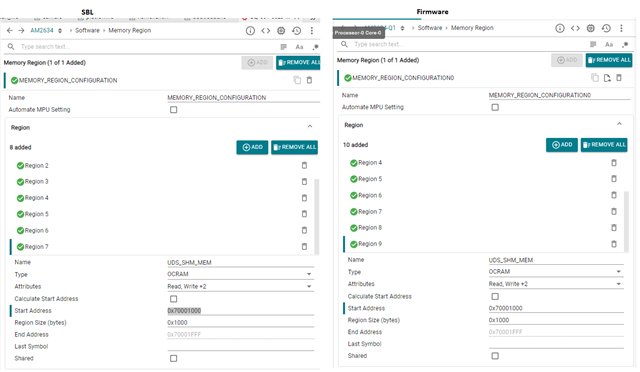

I am currently working on porting firmware from the TMS570LS1227. One of the modules requires data sharing between the firmware and the SBL, so that the UDS transaction initialized in the firmware can be completed in the bootloader. This enables the firmware update to be handled by the SBL afterward.

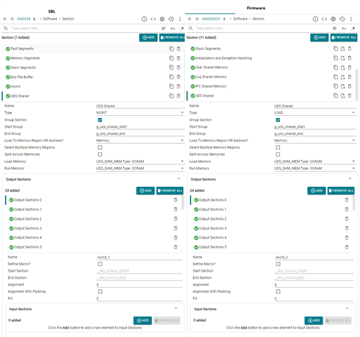

I have used SysConfig to define the UDS_SHM_MEM memory region and the UDS shared section in both the bootloader and firmware projects (see the picture below).
Initially, I implemented a watchdog reset in the firmware. However, after the reset, the RAM content is not retained, and all memory locations are initialized to 0.

    RAM content will be there until you pull out the power
    but ROM would overwrite for the portion it uses and it would initialize the banks it uses, this will happen after any reset warm reset POR etc.

    I’ve successfully implemented sharing of the UDS_SHM_MEM buffer between the firmware and bootloader by moving the buffer to the very end of the available OCRAM (0x701F'F000 – 0x701F'FFFF). My first attempt failed when I placed UDS_SHM_MEM at 0x7005'0000, but the new location works as expected.
    I can also confirm that the memory retains its contents during both watchdog resets and software warm resets.

  • Since there are four memory banks, each 512 KB, available as L2OCRAM, and the first two are being tested by the ROM Bootloader, it should be safe to use the remaining two banks for data sharing between the firmware and the bootloader.
    Thank you very much for your help.
