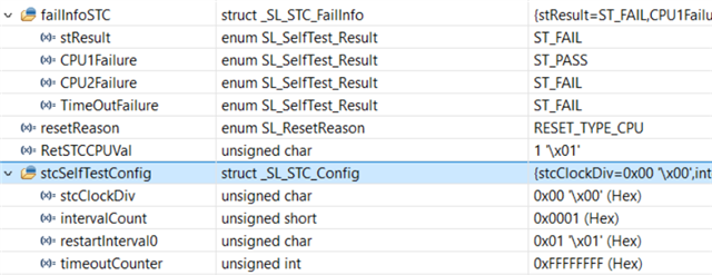

With an TMS570LS3137 platform, I cannot make work the CPU seltest using the SafeTI Library APIs during startup check.
SL_SelfTest_STC(STC_RUN, TRUE, &stcSelfTestConfig)
I am getting following results :
Also using the STC config from the TI Safety Library : restart Interval STC_INTERVAL and STC_MAX_TIMEOUT. do not help
//*CPU Selftest test parameters*/
stcSelfTestConfig.stcClockDiv = 0;                  /* STC Clock divider = 1 */
stcSelfTestConfig.intervalCount = STC_INTERVAL;     /* STC_INTERVAL */
stcSelfTestConfig.restartInterval0 = TRUE;          /* Start from interval 0 */
stcSelfTestConfig.timeoutCounter = STC_MAX_TIMEOUT; /* STC_MAX_TIMEOUT*/
I was reading some other thread but is there is any statement about it to know if I can use it or not.
