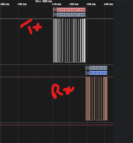

We are using UART DMA to transmit and receive data between the TI AM263Px and a modem, based on the example code: uart_echo_dma_lld_am263px-cc_r5fss0-0_nortos_ti-arm-clang.
 Using a logic analyzer to monitor the TX and RX pins, we observed the following behavior:
When we transmit predefined data (18 bytes) to the modem, we immediately receive a response of 12 bytes from the modem.
As per our application requirements, we need to read this 12-byte response in two stages:
  • First, read 1 byte
  • Then, read the remaining 11 bytes
We are successfully receiving the first byte and getting a receive completion interrupt. However, during the second read attempt, we are not receiving remaining bytes as expected.

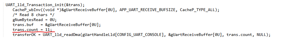

  • Hi Shashank, Thanks for the response.
    I am using API "UART_lld_readDma(gUartHandleLld[CONFIG_UART_CONSOLE], &gUartReceiveBuffer[0U], trans.count, NULL);"  to read the response.
    First time, I am giving trans.count = 1 and getting DMA Rx interrupt. Immediately when i tried to read second time for remaining 11 byets, I am calling same API with trans.count =11, I am not getting any DMA Rx interrupt.
    I used DMA LLD example code with minor modification for the testing. Please find file for  your reference

        UART_lld_Transaction_init(&trans);
        CacheP_wbInv((void *)&gUartReceiveBuffer[0U], APP_UART_RECEIVE_BUFSIZE, CacheP_TYPE_ALL);
        /* Read 8 chars */
        gNumBytesRead = 0U;
        trans.buf   = &gUartReceiveBuffer[0U];
        trans.count = 1;
        transferOK = UART_lld_readDma(gUartHandleLld[CONFIG_UART_CONSOLE], &gUartReceiveBuffer[0U], trans.count, NULL);
        while(try_lock_mutex(gUartObject[CONFIG_UART_CONSOLE].readTransferMutex) == MUTEX_ARM_LOCKED);
        APP_UART_ASSERT_ON_FAILURE(transferOK, trans);
            /* Read 8 chars */
            gNumBytesRead = 0U;
            trans.count = 11;

    2.  For remaining 11 bytes of data, I configured Rx FIFO (trans.count =11) as shown below. However, I did not received any interrupt. I did observe that  next bytes of data were received in the Rx FIFO, but not the complete set of expected data.
    Rx Interrupt is not generated because the remaining 11 bytes of data have not yet been received in the Rx FIFO.
    However, When I use the UART LLD code, I am able to receive Rx interrupt for 1byte and immediately another Rx interrupt for 11 bytes of data
