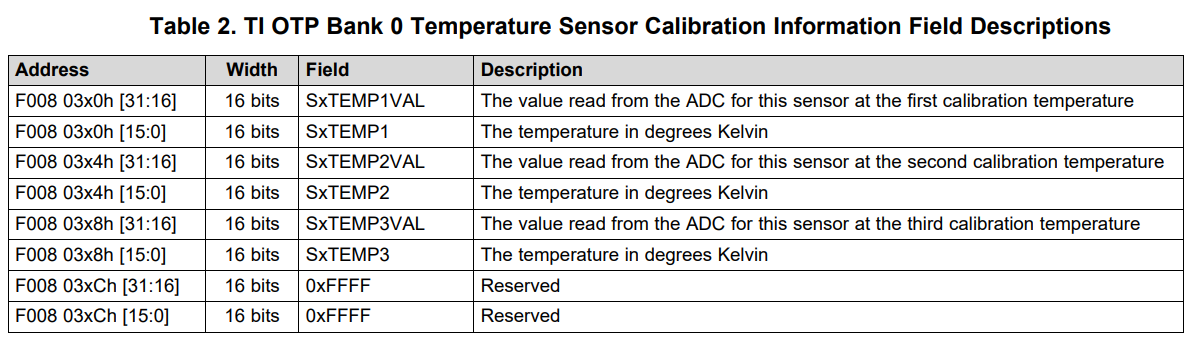

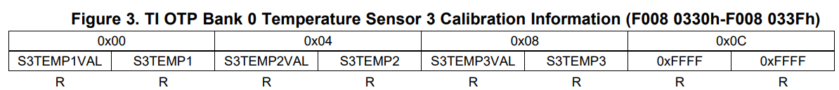

    Can you share the sensor's calibration data stored in OTP at 0xF0080330h-0xF008033Fh
  • Hi Wang,
    Here is the data you had requested.
                                                                                                           ADC | Kelvin
    Address[0xF0080330], data = [0x79A012F] => 0x079A 012F => 1946 | 303
    Address[0xF0080334], data = [0x60E00E9] => 0x060E 00E9 => 1550 | 233
    Address[0xF0080338], data = [0x9D9018E] => 0x09D9 018E => 2521 | 398
    Address[0xF008033C], data = [0xFFFFFFFF] => 0xFFFF FFFF => 65535|65535
  • I got the same offset and slope for sensor 3.
    === sensor 3 ====
    303K ( 90°C, 0x12F) = 1946 (0x79A)
    233K (-40°C, 0x0E9) = 1550 (0x60E)
    398K (125°C, 0x18E) = 2521 (0x9D9)
    slope =0.17
    offset=170.5

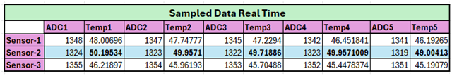

  • Thanks. What's the sampled ADC values (sensor 1/2/3) at temperature Gun=116°C?
  • Sorry, by mistake I clicked on "Resolved". Please keep it open.
    Currently I am collecting samples periodically and it shows, 1368, 1370, 1369....
  • Note that, I am currently collecting from Sensor - 3. I have not tried Sensor 1 and Sensor 2 yet.

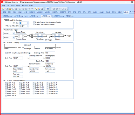

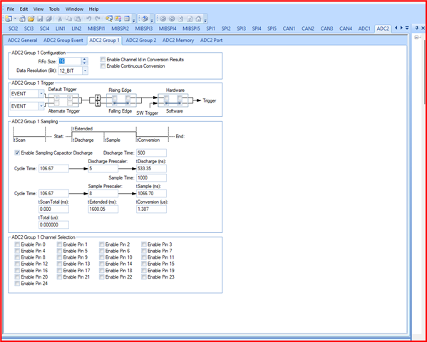

  • What is the ADC configuration: sampling time, discharge time, and ADC clock?
    Is ADREFHI 3.3V and ADREFLO 0V on your board? A difference on ADREF of 5% can result in the calculations being off by 22°C at 125°C junction temperature.
    MibAC2 channel 30 is used to sample sensor 3.
  • Above - ADC configuration. Below code ,

  • The ADC configuration looks fine.
    What are the voltage level of ADREFHI and ADREFLO? Have you read the temperature from sensor1 and sensor 2?
    1368, 1370, 1369 (your measurement) are far less than the expected value for 116°C (temperature Gun).

  • Thanks Wang. I have corrected the channel selection for Sensor-2 and I am getting similar ADC and temperature values. Also I tried with Sensor-1 and same result. All ADC values are in the range of 1300-1350.
    What is the next step, besides measuring the ADREF HI and LO voltages, which may take some time, as I need appropriate equipment.
  •   - Is there any way to change the status of the case. It shows "Resolved", as I by mistake clicked on "This Resolved my issue" button.
  • the ADREF HI and LO voltages,
    You can check the schematics of your board. The TMS570LC43x supports up to 5V ADC power supply and reference HI voltage level. If ADC is not powered by 3.3V, you need to scale the sampled the ADC value.
  • I checked the ADREFHI and ADREFLO differences, and found out to be 5.0V. So I multiplied the ADC sampling value with a factor of (5/3.3) and now I am getting realistic data. However, I am finding about 3 to 4 degree (Centegrade) difference between Sensor-2 and (Sensor-1 and Sensor-3). Sensor-1 and Sensor-3 temperature values looks closer. is it expected?
    The three sensors are located at different locations. It is ok to see different temperatures read by 3 sensors.
