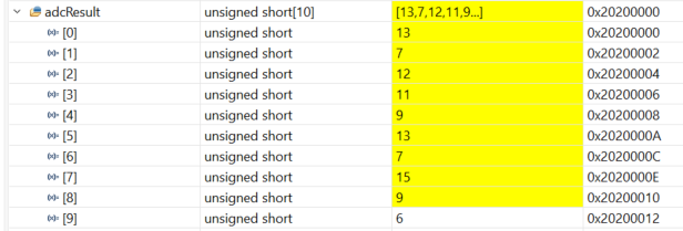

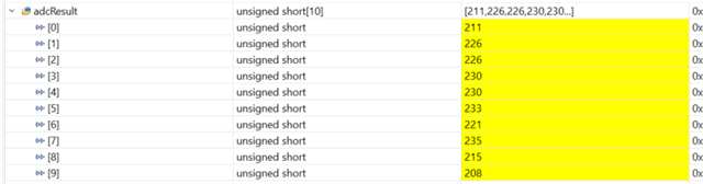

MSPM0G3507: ADC is not working properly, in all setups as expected.
Part Number: MSPM0G3507
Other Parts Discussed in Thread: MSP430F2619
Hi team,
I am testing ADC functionality on both the MSPM0G3507 and MSP430F2619 controllers with the reference voltage configured to 2.5 v.
For an input of 137 mV, I observe the following results:
  • MSPM0G3507 → ~200 ADC counts
  • MSP430F2619 → ~228 ADC counts
The theoretical value for a 12-bit ADC with 2.5 V reference is approximately 224 counts. The MSP430 result is close to expectation, but the MSPM0G3507 result is noticeably lower.
I would appreciate your suggestions on this observation, or if there are any specific settings that need to be activated for accurate ADC conversion on the MSPM0.
