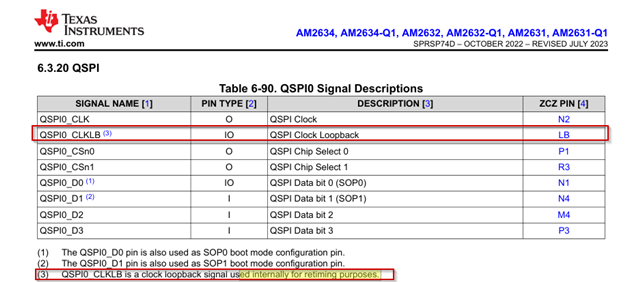

Dear TI Forum,
I am creating a CAD part for the AM2632_Q1 and there is a pin listed as QSPI0_CLKLB with pin 'number' LB. IS this just an internal pin? The package is an 324 pin BGA with normal names A1, A2, B1,B2.... V17, V18 so a pin named LB doesn't make any sense.
Please can you clarify?
Many Thanks,
Iain
