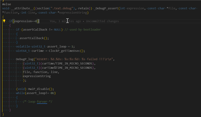

The modification also affects the sections, since we will place some of those functions in a special .text.debug-section like this (the header activates this part, just VSCode does not show it correctly):
Note that in the sdk, those functions are not placed in a section like this!

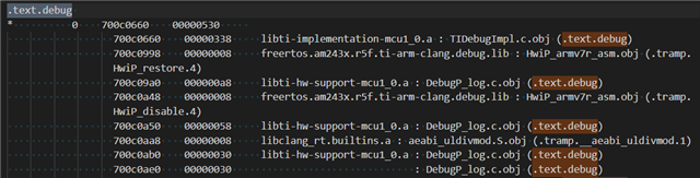

If I now compile without further modifications, our .text.debug-section does not contain those symbols. in contrary, the map-file shows that the ones of the freertos-library are included:
Our library is linked in the link-command before the freertos-library. extract from the link-command:
As soon as I remove the freertos-library from the linker-script, it works and uses our copy of the file from our library:

My guess is, since there is no .text.debug-section-attribute for the functions in the sdk, they differ in their input section to our definitions, and thus the linker would handle them differently?
What am I doing wrong here?
Edit: I tested it by removing our section-attributes and then it works with including both libraries in the linker-script. so putting those functions into a separate section, other than in the sdk, seems to be the problem.
Unfortunately we had a reason why this was needed, but it's some time ago and I will find out.
Is there a possibility to achieve the replacing of the sdk-library functions while at the same time, placing them in a different section than the one in the sdk?
