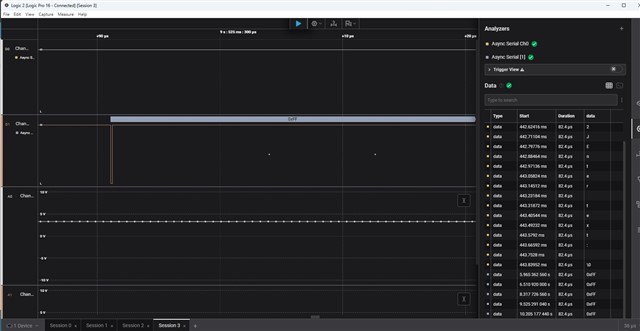

I modified demo project uart_echo a little bit to use UART7. I connected the eval board to my laptop through USB to TTL cable then started the debugger and Putty. The main function sent a prompt string to UART and I could see it in Putty. But if I typed something in Putty, it didn't echoed back. What I typed were supposed to be received by UARTIntHandler(my UART ISR) then wrote back to the UART. But that didn't happen. I set a breakpoint in the ISR at line after line: char c = MAP_UARTCharGetNonBlocking(UART7_BASE); The breakpoint was just hit once. It was after the program was launched. When I typed anything in Putty, the break was not hit. I don't know what was wrong.
Here is main()

    MAP_UARTConfigSetExpClk(UART7_BASE, g_ui32SysClock, 115200,
                            (UART_CONFIG_WLEN_8 | UART_CONFIG_STOP_ONE |
                             UART_CONFIG_PAR_NONE));
    // Enable the UART interrupt.
    MAP_IntEnable(INT_UART7);
    MAP_UARTIntEnable(UART7_BASE, UART_INT_RX | UART_INT_RT);
    // Prompt for text to be entered.
    UARTSend((uint8_t *)"\033[2JEnter text: ", 16);

    while(1)
ISR:
void
UARTIntHandler(void)
    uint32_t ui32Status;
    // Get the interrrupt status.
    ui32Status = MAP_UARTIntStatus(UART7_BASE, true);
    // Clear the asserted interrupts.
    MAP_UARTIntClear(UART7_BASE, ui32Status);
    // Loop while there are characters in the receive FIFO.
    while(MAP_UARTCharsAvail(UART7_BASE))
        // Read the next character from the UART and write it back to the UART.
        MAP_UARTCharPutNonBlocking(UART7_BASE,
                                   MAP_UARTCharGetNonBlocking(UART7_BASE));

      Can you show either a scope cap or logic analyzer capture of the TX and RX signals?
  • Thanks for the response. Here is the output from the logic analyzer. ch0(yellow) connects to the Tx on the board. So we see the prompt text. Ch1(blue) connects to the Rx on the board. It's obvious the signal are not right. It's all 0xFF at very early stage and it's before the prompt displayed. All I typed on the terminal triggers no signal. However, the USB-TTL cables Tx led was blinking when I was typing. Please see attached image.
  • HI,
      What is the baudrate you configure for the terminal window? Is it 115200? Can you also check the status register on the UART7 for any errors?
  • 115200. If I don't connect the USB-TTL's Tx end to the board's Rx pin, and connect analyzer to that TTL's to Tx end, I can get the right signals. That means my eval board's PC4 pin drags the signal to constant high. I seems remember I connected USB-TTL's vcc wire to the one of GPIO pin. The board was partially damaged. Now I use my backup board, it works properly! Thank you so much for taking care of my question.
