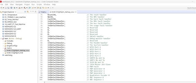

When I was checking the function of Timer, I can not enter ISR.
The system stuck in static void IntDefaultHandler(void) of tm4c123gh6pm_startup_ccs.c.
These are the code below.
Are there any problems in the code? Or how can I solve the problem?

  • The system stuck in static void IntDefaultHandler(void) of tm4c123gh6pm_startup_ccs.c.
    Hi Norton,
      Can you show your startup_ccs.c code? You need to make sure you have a vector declared for Timer_A in the vector table. By default, the startup file is filled with IntDefaultHandler for all vectors. See below example. Please also make sure you use the startup_ccs.c file for TM4C123 and not copy the any starrtup file from MSP432P as they are not compatible.
  • Hi Charles,
    Thanks for the replying.
    Where can I find the startup_ccs.c file the the TM4C123?
    There is only tm4c123gh6pm_startup_ccs.c file in the created project.
    I have showed my tm4c123gh6pm_startup_ccs.c and there are not any IntHandler in the file but lots of InfDefaultHandler.
    Should I need to edit the Handler by myself?
    It seems that I can not just change the "InfDefaultHandler" to the function of my ISR.

  • I have showed my tm4c123gh6pm_startup_ccs.c and there are not any IntHandler in the file but lots of InfDefaultHandler.
    Sure I do not copy any file from MSP432P.
    I created a new project for the TM4C123 and and linked TivaWare_C_Series-2.2.0.295.
    How did you create the project? I don't think you created the project by importing an existing project from the TivaWare SDK. There is already a timer project that exactly demonstrates what you want to accomplish. Please do as follows.
    1. Import the timers project from C:\ti\TivaWare_C_Series-2.2.0.295\examples\boards\ek-tm4c123gxl\timers. Please note it is to import, NOT copy the project. The TivaWare examples are prebuild and are ready to run out of box. All you need to is to import them into the CCS workspace. To import a project in CCS, go to File->Import and project the path to C:\ti\TivaWare_C_Series-2.2.0.295\examples\boards\ek-tm4c123gxl\timers.
    2. Run the timers example project. You should see LED blinking on the LaunchPad after the timer expires. There are two timers configured and they are TIMER0_A and TIMER1_A in this example.
    3. Look at the startup_ccs.c file. All TivaWare examples have the startup_ccs.c file, not tm4c123gh6pm_startup_ccs.c. You might have imported some examples from the Resource Explorer. Is that correct.
    4. In any case, always start with a working example from the SDK as all examples in the SDK have the correct CCS build settings and necessary files (startup file, cmd file and etc) to build the project.

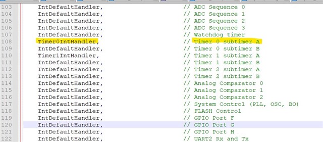

    3.I have checked the startup_ccd.c file.
    The Handlers for use are Timer0IntHandler and Timer1IntHandler.
    What should I do if need to use other interrupt function?

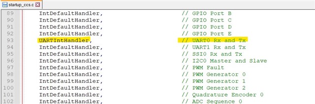

    It usually needs several interrupt functions, like UART, Timer, I2C, ADC, etc.
    You just plug in the ISR vectors for the peripherals you want. Let's take UART0RX for example. You would add and vector that points to the ISR for UART. See below example. Whenever the UART0 receives data, it will generate an interrupt and the processor will jump to UARTIntHandler to process the interrupt.

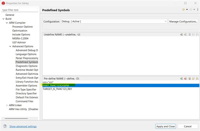

    How can I change the pinmuxing code?
    Can I just right click on the project, select properties->CCS General, and select the chip on the list, Variant?
    If not, please let me know how I can do to change the pinmuxing code for the other MCU.
    On the other hand, if the operations for setting chip is correct, the pinmuxing code will be replaced into the same chip as the properties, right?

  • Hi Norton,

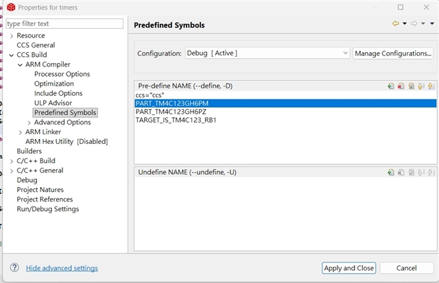

      Please see below. Please change from PART_TM4C123GH6PM which comes with the TivaWare SDK to PART_TM4C123GH6PZ. TivaWare SDK has PART_TM4C123GH6PM because the TM4C123GH6PM (64pin) is the package used on the EK-TM4C123GXL Launchpad evaluation board.

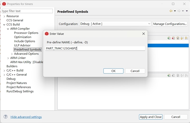

  • Hi Charles,
    There is no "PART_TM4C123GH6PZ" option in the list.
    I used "Add..." button to add "PART_TM4C123GH6PZ" and select.
    I have no idea if this is correct.
      You can remove the PART_TM4C123GH6PM  and just keep PART_TM4C123GH6PZ.
