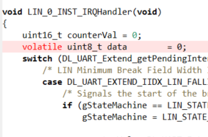

I run demo code lin_responder with MSPM0L1306 LaunchPad Development Kit. The LIN master is Vector VN1630.
There are little change with demo code, see below pictures.
The TX and RX is abnormal and can not recover when enter else condition after DL_UART_EXTEND_IIDX_RX interrupt.
It happens accidental when LIN master start stop periodic with LIN slave keep power on, or happens accidental when LIN slave power on off periodic with LIN master keep work.
Why received SYNC byte is not 0x55? What function can be invoked to restart LIN, I try to use DL_UART_Extend_reset() but no change.

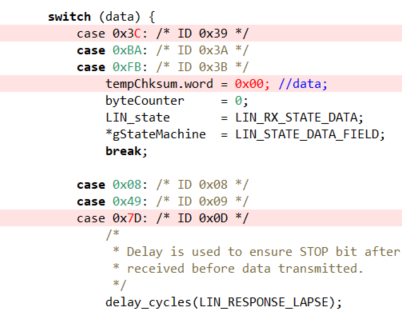

  • Hi Bian,
    Why are you setting all of your PID as zero when you calculate your checksum? I think this will mess with your LIN communication since the checksum should include the PID into its calculation. As in the else condition you mentioned, it seems the state the original example had is StateMachine = LIN_STATE_WAIT_FOR_BREAK; rather than LIN_STATE_BREAK_FIELD. I recommend putting the original state from the example and see if it fixes the issue. I also recommend leaving the gAutoBaudUsed option in there since it can sometimes help avoid this kinds of wrong functionality. You can use DL_UART_Extend_reset() or toggle the power of the module, but you'll need to re-configure the UART LIN module.
    Diego Abad
  • Hi Diego,
    thanks for your info.
    The PID 0x3C and 0x3D are classic checksum.

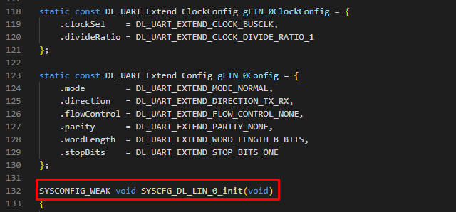

    Where is gAutoBaudUsed option? i does not find auto buad in TRM? Does MSPM0L1306 support auto buad?
    What function must be invoked for reset LIN? I use SYSCFG_DL_LIN_0_init(), but it does not work.

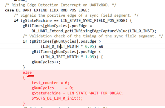

    I find the time of sync is invalid when issue happen, enter else condition in below picture.

  • Hi Bian,

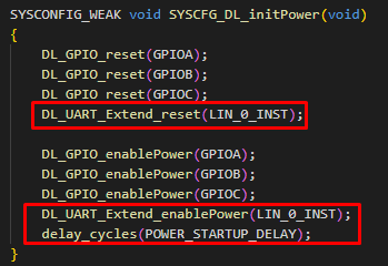

    The auto baud rate is an option handled through a process inside the code that most of our examples have by default. Here's a link to the code you can copy for this device.
    You will use the reset function or the turn off/turn on functions to reset the UART-LIN Module. However, once you do this, you'll need to reconfigure it. You can find those functions inside the ti_dl_sysconfig.c file.

  • Hi Diego,
    I add code in else of rising edge interrupt detection, the issue seems fixed. Please help confirm if there is potential risk with the change. Thanks!

  • Hi Bian,
    I don't think there should be an issue with that. Glad to hear the code seems to be working.

                        averageBitTime   = gTotalBitTime / gNumSyncErrors;
                        measuredBaudRate = LINUART0_INST_FREQUENCY / averageBitTime;
                        DL_UART_disable(LINUART0_INST);
                        delay_cycles(AUTO_BAUD_CONFIG_DELAY);
                        DL_UART_disableFIFOs(LINUART0_INST);
                        gLinResponseLapseVar =
                                LINUART0_INST_FREQUENCY / (2 * measuredBaudRate);
                        gLin0TbitWidthVar = averageBitTime;
                        DL_UART_configBaudRate(
                            LINUART0_INST, LINUART0_INST_FREQUENCY, measuredBaudRate);
                        DL_UART_Extend_setLINCounterCompareValue(LINUART0_INST,
                            gLin0TbitWidthVar * LINUART0_TBIT_COUNTER_COEFFICIENT);
                        DL_UART_Extend_enable(LINUART0_INST);
                        gPrevBaudRate = gCurrBaudRate;
                        gCurrBaudRate = measuredBaudRate;
                        gAutoBaudUsed = true;
                        gStateMachine = LIN_STATE_SYNC_FIELD_NEG_EDGE;
                    else {
                else if (gStateMachine == LIN_STATE_SYNC_FIELD_NEG_EDGE)
    #if 1
                    pos_edge_counter++;
                    if (pos_edge_counter >= 10)
                        pos_edge_counter = 0;
                        gNumCycles     = 0;
                        gStateMachine = LIN_STATE_WAIT_FOR_BREAK;
                        DL_UART_Extend_reset(LINUART0_INST);
                        DL_UART_Extend_enablePower(LINUART0_INST);
                        delay_cycles(POWER_STARTUP_DELAY);
                        SYSCFG_DL_LINUART0_init();
                        delay_cycles(512);
    #endif
                break;
            /* Counter Overflow Interrupt. */
            case DL_UART_EXTEND_IIDX_LIN_COUNTER_OVERFLOW:
                break;
            /* Negative Edge Detection Interrupt on UARTxRXD. */
            case DL_UART_EXTEND_IIDX_RXD_NEG_EDGE:
                /* Signals the negative edge of a sync field segment. */
                if (gStateMachine == LIN_STATE_SYNC_FIELD_NEG_EDGE) {
                    /* If flag for overrun has gone off and previous
                     * baud rate < current baud rate, turn counter off and on. */
                    if ((gCurrBaudRate > gPrevBaudRate) &&
                        DL_UART_getErrorStatus(
                            LINUART0_INST, DL_UART_ERROR_OVERRUN)) {
                        DL_UART_disableLINCounter(LINUART0_INST);
                        DL_UART_enableLINCounter(LINUART0_INST);
                    gBitTimes[gNumCycles].negEdge =
                        DL_UART_Extend_getLINFallingEdgeCaptureValue(LINUART0_INST);
                    gStateMachine = LIN_STATE_SYNC_FIELD_POS_EDGE;
                break;
            /* UARTxRX Data Detection Interrupt. */
            case DL_UART_EXTEND_IIDX_RX:
                /* Determine if SYNC byte was received */
                if (gStateMachine == LIN_STATE_SYNC_FIELD_POS_EDGE) {
                    data = DL_UART_Extend_receiveData(LINUART0_INST);
                    if (data == LIN_SYNC_BYTE) {
                        /* First received byte is SYNC. Ignore it and wait for PID */
                        gStateMachine = LIN_STATE_PID_FIELD;
                    } else if ((data != LIN_SYNC_BYTE) && gAutoBaudUsed) {
                        /* Incorrect baud rate can cause an incorrect sync byte to be received.
                         * If autobaud was used and the sync byte was incorrect, the state machine
                         * proceeds as usual.*/
                    } else {
                        /* Unexpected byte, return to idle status */
                else if (gStateMachine == LIN_STATE_PID_FIELD) {
                    /* Process the PID. The state machine will be updated */
                    setLINResponderRXMessage(data, &gStateMachine);
                /* Signals the data field */
                else if (gStateMachine == LIN_STATE_DATA_FIELD) {
                     *  Process data byte.
                     *  If data byte matches ID byte from "responderMessageTable"
                     *  then performs the matching function. Otherwise does nothing.
                /* Flushes any data that comes after an invalid PID*/
                else if (gStateMachine == LIN_STATE_WAIT_FOR_BREAK) {
                break;
            default:
                break;
    br

  • Hi Bian,
    I would recommend to debug the code so that you make sure that each data that you receive is the correct data, and see why the checksum gives you the wrong value. I do see that you have one way to find the checksum different from the example, but I'm not 100% sure if it affects the end result for checking the incoming checksum and that checksum you calculate there (lines 184 to 199). However, I would recommend to use two different checksum variables to avoid mixing values from those two processes.
    Diego Abad
  • Hi Diego,
    The issue is resolved.
    There are 3 changes in demo code 'lin_commander_LP_MSPM0L1306_nortos_ticlang' of mspm0_sdk_2_06_00_05.
    1, calculation formula of checksum;
    2, reinit must be invoked when rising edge interrupt happen and gStateMachine == LIN_STATE_SYNC_FIELD_NEG_EDGE;
    3, disable rx interrupt is invoked after receive break field
