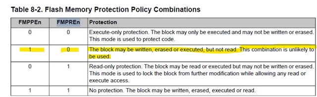

    What is the setting of FMPPE0 when you set FMPRE0 to 0? I suppose you are trying to enable execute-only protection, correct? You need to make sure that when you compile your code there is no literal data access to the blocks that you restrict to execute-only. Any literal data access to a execute-only block will be blocked. Please refer to the datasheet for details.

  • What is the setting of FMPPE0 when you set FMPRE0 to 0? I suppose you are trying to enable execute-only protection, correct? You need to make sure that when you compile your code there is no literal data access to the blocks that you restrict to execute-only. Any literal data access to a execute-only block will be blocked. Please refer to the datasheet for details.
    When the value of FMPRE0 is 0x00000000 and the value of FMPPE0 is 0xFFFFFFFF, the data written to the Flash Memory is all 0xFF. After we finish programming the above data, the SWD interface cannot be halt-enabled.Please help analyze the possible causes.
    This is an unrealistic combination (FMPRE0=0 and FMPPE0=1) to allow program/erase to flash but not reads. Please refer to the datasheet.

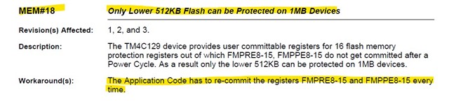

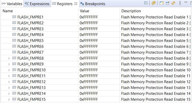

      I program the FMPRE8-15 registers. See below first image. It works until the next power cycle. See the second image. After a power cycle, the FMPRE8-15 are not committed. I realized the issue is due to the MEM#18 errata. Please refer to the errata for details. You would need to recommit the register each time in your application after a power up.
    After the power cycle, the FMPRE8-15 registers become 0xFFFFFFFF again.
    Below is the code I use the program FMPRE8-15
        HWREG(FLASH_FMA) = 0x10;
        HWREG(FLASH_FMPRE8) = 0x0;
        HWREG(FLASH_FMC) = FLASH_FMC_WRKEY | FLASH_FMC_COMT | FLASH_FMC_WRITE;
        while(HWREG(FLASH_FMC) & FLASH_FMC_COMT)
        HWREG(FLASH_FMA) = 0x12;
        HWREG(FLASH_FMPRE9) = 0x0;
        HWREG(FLASH_FMA) = 0x14;
        HWREG(FLASH_FMPRE10) = 0x0;
        HWREG(FLASH_FMA) = 0x16;
        HWREG(FLASH_FMPRE11) = 0x0;
        HWREG(FLASH_FMA) = 0x18;
        HWREG(FLASH_FMPRE12) = 0x0;
        HWREG(FLASH_FMA) = 0x1a;
        HWREG(FLASH_FMPRE13) = 0x0;
        HWREG(FLASH_FMA) = 0x1c;
        HWREG(FLASH_FMPRE14) = 0x0;
        HWREG(FLASH_FMA) = 0x1e;
        HWREG(FLASH_FMPRE15) = 0x0;

          I would like to confirm with you again that the FMPRE8-15 register cannot be set during the programming process of the TM4C1290NCPDT chip. Is that correct?
    Correct. You need to recommit the registers after reset in your application.

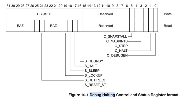

    The command to write 0xA05F0003 to 0xE000EDF0, enabling debug and requesting the kernel to halt, failed to send.
    Can you tell me who is writing to the 0xE000EDF0? This is the Debug Halting Control and Status register inside the Cortex-M4F processor. Normally, this is written by the debugger. Which debugger do you use? Do you happen to have the Memory Browser open? If you have the Memory Browser open then the debugger will read the flash content
