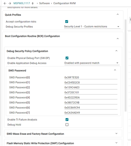

Hello TI Experts,
I'm working with the MSPM0L1117 and using the SEGGER J-Link debugger with a custom J-Link script to enable debug access with password protection.
Objective:
I want to configure the device with full security:
  • Protect debug access (SW-DP)
  • Protect factory reset
  • Protect mass erase
    All using a password authentication scheme by custom J-link script.
  • Primary Questions:
    1. What format is expected by the MSPM0 device in the SEGGER J-Link script:
      • Is it expecting a raw 128-bit password (as 8 x 32-bit words)?
      • Or is it expecting a 256-bit SHA-256 digest of that 128-bit password?
    2. In TI SysConfig (see attached screenshots), I see that passwords must be given as a 256-bit SHA-256 hash (8 x 32-bit).
      • How does this correlate with what I must provide in the SEGGER script?
      • Should the script send the raw password (pre-hash)?
      • Or does the script also require the final SHA-256 hash (post-hash)?
        Reference Screenshots & script:
        • Image 1: TI SysConfig settings showing password fields and SHA-256 hash requirement.
           Script snippet used with SEGGER J-Link.
          Log output from J-Link showing password being accepted but failure to connect to the core.
          What I need from TI:
          1. Clarification on password formats:
            • What format is expected in the SEGGER script?
            • What format is required in TI SysConfig?
          2. A working example of:
            • A known 128-bit password (for example: 0xCAFECAFE12345678A5A5C3C30000FFFF)
            • The corresponding 256-bit SHA-256 hash
            • A valid SEGGER J-Link script snippet for MSPM0L111x that unlocks debug access using that password (covering Debug + Mass Erase + Factory Reset protection).
              Setup Summary:
              • Target: MSPM0L1117 (LQFP-48)
              • Tool: SEGGER J-Link with InitTarget() script
              • Protection mode: Security Level 1 – Custom Restrictions

    The basic theory is that the actual password can not be directly written into flash memory. If someone have the access to your flash memory, they still can not get your password directly.
    So, according to this theory, the data you have written into the NONMAIN is 256-bit SHA-256 digest data which has been encrypted at this stage. And it is expected a raw 128-bit password to be written in the script.
    Cash Hao
  • Hi Cash,
    Thank you for clarifying the theory around 128-bit password and 256-bit SHA hash.
    However, I still need help with the following:
    1. Can you please provide a working SEGGER J-Link script that:
      • Sends a 128-bit password correctly
      • Supports password-protected Debug Access
      • Also protects Factory Reset and Mass Erase
      • Works with Security Level 1 set via TI SysConfig
    2. Can you confirm if the existing SEGGER example supports all these protections or if additional command/AP switch logic is required?
    3. I'm currently getting the following issue even after correct password entry:
      Could not find core in Coresight setup
      Attach to CPU failed.
    Could this be due to missing steps in my script or mismatched AP settings?
    Any complete working example would be greatly appreciated, especially with:
    • A sample 128-bit password
    • Its 256-bit SHA hash (for SysConfig)
    • J-Link script steps required to unlock and connect to the device securely
    Thank you!
