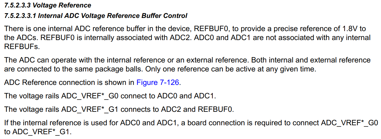

Hello team,
in AM261 only ADC2 has its own reference through REFBUF0.
How is it possible to use the other two ADCs with this reference?
Is it enough to connect the reference voltage to ADC_VREF*_G0 and ADC_VREF*_G1?
Manuel

Hi Manuel,
You will need to connect ADC_VREF*_G0 and ADC_VREF*_G1 to use internal reference for ADC0/1.
