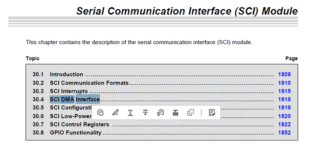

    It is quite challenging without DMA for this kind of large data applications. These are the some suggestions that you can try once.

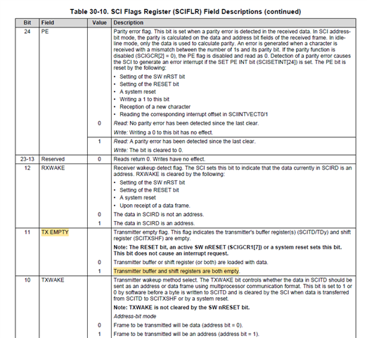

    1. On transmitting side make sure to write only if TX EMPTY flag is empty, because this ensures both shift register, and data registers are empty and eventually this creates some additional delay as compared with TXRDY flag.
    2. And i don't understand why you are not using DMA on at least receiving end even though device supports it.

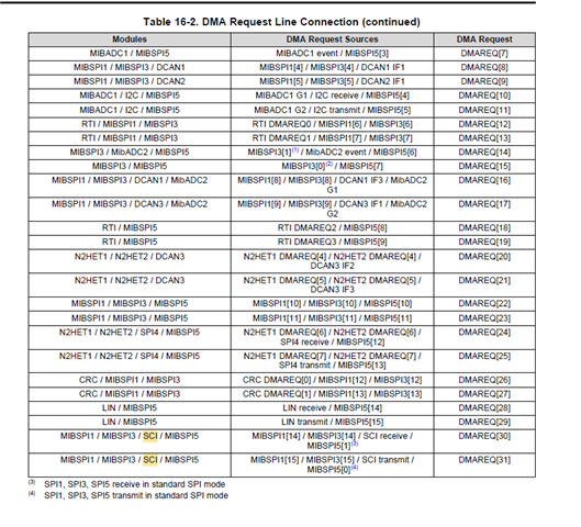

    I’ve implemented DMA for SCI.
    I need to receive a fixed number of bytes. I’m using DMA for TX, and it works fine — I’ve verified it using Docklight. Every one second, I’m sending 8 KB of data through DMA at a baud rate of 230400.

  • Hi Sajith,
    Apologies for the delayed response.
    Your DMA configuration seems fine to me. Can you please try below method once:
