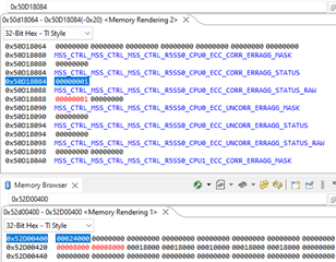

When 1 bit error is injected in ATCM R5SS0 memory and read memory to trigger ECC error. This will set following registers
MSS_CTRL
Set 50D18084h and 50D18088h for 1 bit error
Set 50D18094h and 50D18098h for 2 bit error
ESM
Set 52D00420h and 52D00424h for ECC Core 0.
According to SDK sdl_ecc_r5_atcm0 example, to clear TCM errors, writing 1 to 0x50D18084h and 0x50D18088h for 1 bit error and writing 1 to 0x52D0042C (ESM_PCR_GENERATED_MEMORY_MAP_ERR_GRP_INTR_EN_CLR_J Register).
This will reset 0x52D00424h but 0x52D00420h is still set to 1.
How to reset the 0x52D00420h ESM_PCR_GENERATED_MEMORY_MAP_ERR_GRP_RAW_J Register to clear TCM errors?

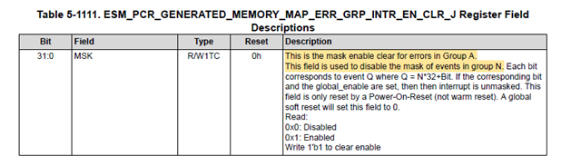

  • Hi Minni Yadav,
    Before writing 1 to the 0x52D0042C, also write one to the 0x52D00424.
    Try below sequence:
    1. First write one to the 0x52D00424, this should clear the interrupt status as per the TRM:
    2. And after this now you can write 1 to the 0x52D0042C, this should clear error status register and also disables the mask of events.
    Could you please try this sequence and let me know the results.

  • I attempted the sequence described above. Using only the first step, I am able to reset the RAW register.
    I perform one-bit and two-bit ECC error injections. After a one-bit error is injected, the ESM status flags are set. After clearing the ESM interrupt status (by writing 1 to 0x52D00424), I inject a two-bit error and read the corrupted memory.
    However, the ESM status registers are not set. When executed individually, both one-bit and two-bit injections set the status flags as expected. Yet, if a one-bit error is injected and its status flags are subsequently cleared, a subsequent two-bit injection fails to set the corresponding flags.
    What additional steps are required to perform error injections sequentially (i.e., one immediately after the other)?
  • Hi Minni Yadav,
    Apologies for the delayed response:
    As i mentioned here i think this second one also clears the enable mask, that means it will stop further interrupt triggers for corresponding group.
    Try below sequence:
    After one-bit error
    1. Write one to the 0x52D00424, this should clear the interrupt status.
    Now perform two-bit error injections:
    2. Again, write one to the 0x52D00424, this should clear the interrupt status.
    Now both injections tests completed right, so now you can write 1 to the 0x52D0042C, this should clear error status register and also disables the mask of events.
    Thanks & regards,
    Jagadish.
