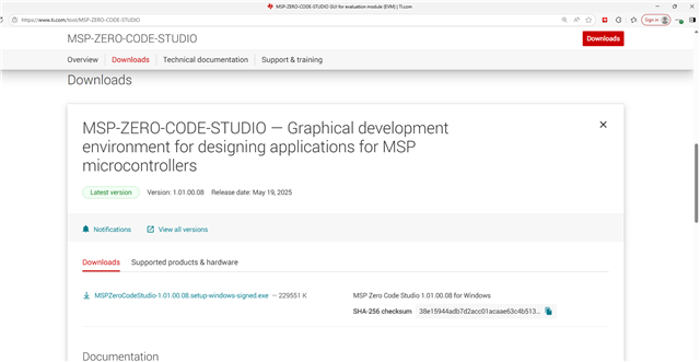

  • Hello Ivan,
    The current version on ti.com is the latest version. Re-installing is a method that customer can try.
    What does the "saving functionality issue" mean?
    Janz Bai
  • It means that program is not saving current project state. It saves old project.
    Example: I open File1.syscfg. Add one extra block to project. Save file to File2.syscfg. Check that files are identical (no changes).
    I have tested on my side using the latest Zero Code Studio downloading from ti.com. I can't find this issue. Please try to download the latest version from ti.com and try it again.
    MSP-ZERO-CODE-STUDIO GUI for evaluation module (EVM) | TI.com
    Janz Bai
