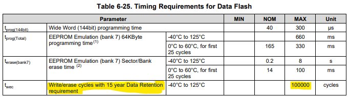

I am currently working on a safety-critical embedded application using the TMS570 microcontroller, where we utilize Flash Bank 7 for internal EEPROM emulation via the F021 Flash API. As this region is used to store critical runtime data, we seek clarification on its reliability and long-term performance characteristics.
1. what is the maximum number of read/write cycles supported by bank 7?
    100K write/erase cycles. please refer to the device datasheet

    3. What is maximum data retention time for bank 7?
