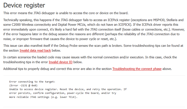

 CS_DAP_0: Error connecting to the target: DAP Connection Error. This could be caused by the device having gone to low power mode. Try forcing an external reset. If the error persists, try forcing BSL, a Mass   erase or a   Factory Reset.
  Sometimes the device responds again after a reset or power cycle, but other times it remains completely inaccessible. I also tried the MSPM0_Mailbox_FactoryReset_Manual script, but it’s not working reliably on this    board. Could you please suggest a permanent  fix for this issue?

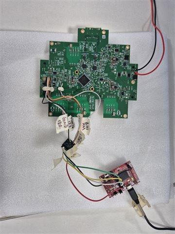

  • Hi Ramalingam,
    Can you take a picture of the board you are using?

  • Hi Owen,
    I’m working with the LP-MSPM0C1104 LaunchPad, which contains the MSPM0C1103 device, and using the XDS110 USB Debug Probe through CCS. I was able to flash the firmware successfully a couple of times, but later it started failing with the following error:
    Error connecting to the target: Connection to MSPM0 core failed. Possible root causes:
    • Debug access within NONMAIN was disabled or enabled with password
    • Peripheral misconfiguration (e.g., improper watchdog or clock)
    As suggested earlier in the forum, I followed the recovery steps and used the MSPM0_Mailbox_FactoryReset_Manual script via CCS. This resolved the issue initially and allowed me to flash again. However, a similar error has now reappeared:
    CS_DAP_0: Error connecting to the target: DAP Connection Error. This may be caused by the device entering low power mode. It suggests trying an external reset, BSL mode, mass erase, or factory reset.
    I’ve repeated the same recovery steps using the XDS110 USB Debug Probe, but the issue persists. That’s what I meant when I said the solution is “not working reliably” — it worked once, but is no longer effective in resolving the current issue.

  • Hi Ramalingam,
    I understand what you are using, but if you could provide more information it would allow me to assist you better.
    1. Can you take a picture of the board you are using? This will help me see exactly how your board is set up and the board version you are using.

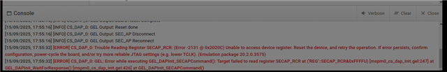

    Trouble Writing Register SECAP_TCR: (Error -2131 @ 0x20204) Unable to access device register. Reset the device, and retry the operation. If error persists, confirm configuration, power-cycle the board, and/or try more reliable JTAG settings (e.g. lower TCLK). (Emulation package 20.1.0.3372) [6/20/2025, 5:37:25 PM] [ERROR] CS_DAP_0: GEL: Error while executing GEL_DAPInit_SECAPCommand(): Target failed to write register SECAP_TCR at 'REG'::SECAP_TCR=command

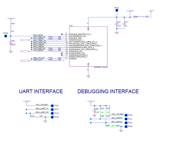

  • Hi Owen,
               Here I am providing the details for your reference
                     Figure 1
                 1.NRST Pin: The NRST debug signal is directly connected to the MCU’s NRST pin in this setup.
                 2.Low Power Mode: No low power mode policy is being used in this project.
                 3.Pins/Peripherals Used:
                     Figure 2

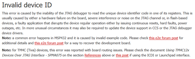

                   I used UniFlash  and CCS to flash the firmware, and initially it succeeded. However, we later encountered the following error.
                   Figure 3
                     To recover, we ran the MSPM0_Mailbox_FactoryReset_Auto script using the same setup, as suggested in the MSPM0 documentation.                               However, after executing the script, we encountered a new error.

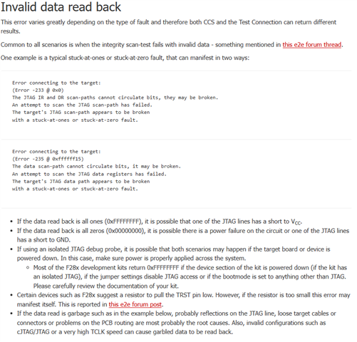

    So when you perform the script to factory reset, the LaunchPad and your custom PCB are powered off? Ensure that both are disconnected to power to guarantee that absolutely no power is being supplied.
    Is it possible for you to try the connection without the level shifter? Or is the custom PCB not rated for 3.3V?
    Something you can check is the current from the level shifter. There's a slight chance that driving too many pins can degrade the signal integrity.
    Do you experience the issue if you set up the LaunchPad to flash the MSPM0C1104 on the LaunchPad?
    The error on the Factory Reset makes me want to believe that the board may not be receiving power or something related to JTAG:
    Here's the link to the Debugging JTAG Guide.
    Owen

  • Hi Ramalingam,
    Is it possible for you to do this without the level shifter?
    My thought is that you are either putting the device into a bad state and that is why it may continue to be unable to be connected to, there may be a power issue, or there is an issue with the JTAG.
    Is it possible for you to share your code so I can do a review?
    Owen

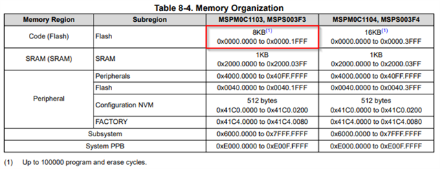

    Also, we have another working board, and the requirement is to erase and reprogram only a specific range of code in memory — not the entire flash.
    Is it safe to do this on MSPM0C1103 using J-Link (Segger) tools, or could partial erase/write operations cause the MCU to enter a locked or unrecoverable state?

    What range of memory are you partially erasing and reprogramming for the other board? We are exploring whether it's possible to erase and reprogram the main memory by specifying the address range. For example, flashing only from 0x0000 to 0x2000 instead of the entire memory.

    As for the memory between 0x0000 and 0x2000, I don't think this is an issue either since it is all of the code region:
