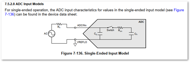

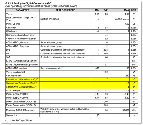

  • The ADC input model can be found in the TRM:
    The parameterisation values can be found in the datasheet. For example (AM263Px):

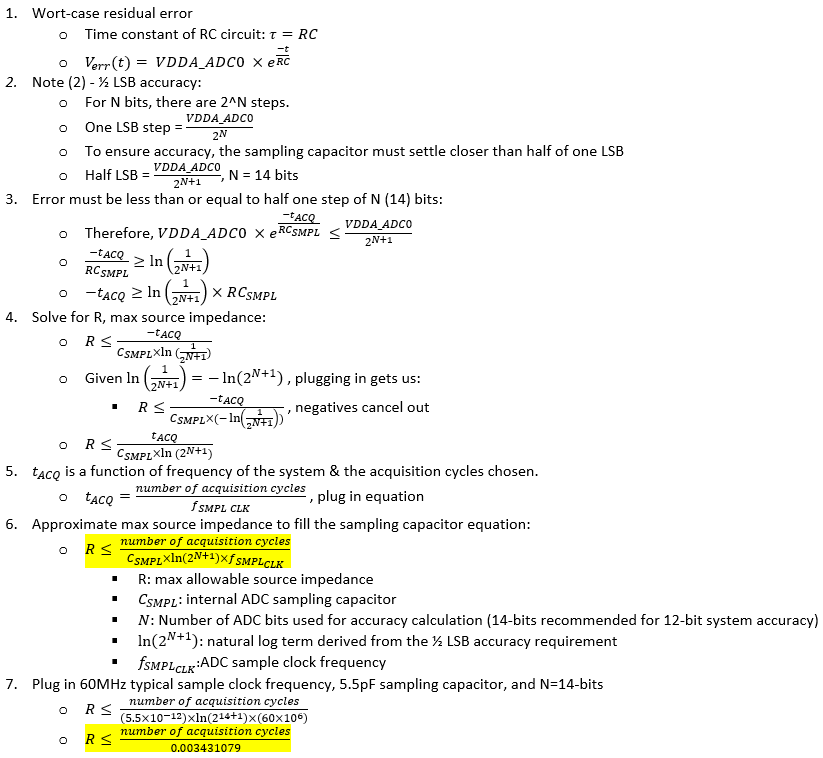

  • Hi Hideaki,
    The AM243x ADC input impedance depends on how well the source impedance charges the internal sampling capacitance within the programmed acquisition time and sampling frequency.
    Here is the procedure to get the equation for maximum source impedance and configurable number of acquisition cycles to fill the sampling capacitor (highlighted part is the final equation):
    Note:
    • The formula is derived derived using 14-bit settling to ensure the system maintains12-bit system accuracy, as recommended in the datasheet.
    • Minimum/maximum t_ACQ values are given in the AM243x Datasheet, Section 6.7.8 ADC10B Electrical Characteristics (ALX package).
    • The associated register field is given in the AM243x TRM, Section 12.1.1.6.16 ADC_STEPDELAY_j Register.

  • Thank you for the response, Kier! Unfortunately, the parameters you have shown don't exactly line up with what we provide in the AM243x datasheet and TRM. I have responded with a more tailored response to AM243x.
    Karam
