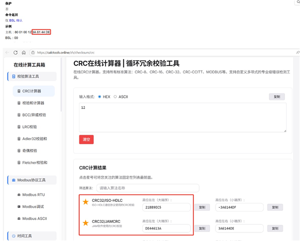

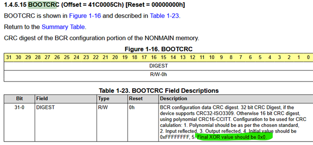

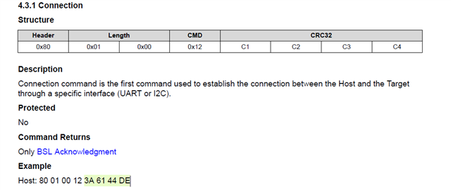

My customer refers to our AN, slau887- MSPM0 Bootloader, to develop their boot code. And need CRC. It shows we need follow CRC32-ISO3309 polynomial and Final XOR value should be 0x0 shown as below.
Since most CRC32 calculation tools use Final XOR value = 0x1 we find, so want to get your help to know if CRC32-ISO3309 have specific definition of XOR value? It would be better if you can share ISO 3309 standard with us. Thanks!
