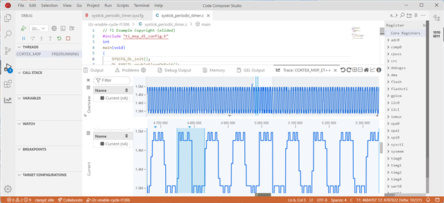

  • Since this question also came up in another thread, I set up a simple-minded experiment which simply toggled the I2C ACTIVE (enable) bit periodically. EnergyTrace indicated the enabled/disabled difference at about 120uA
    Specifically, I started with the SysTick example for the MSPM0L1306 and I
    1) Changed the SysTick period to 50ms (big enough to see, small enough to get many samples)
    2) Configured the I2C unit as Master, 100kHz, on PA0/1 using the Launchpad's on-board pullups. Nothing was connected to the pins.
    3) Removed the LED code and (to be sure) removed the LED jumpers. I also removed the TXD/RXD jumpers from J101.
    4) The low-power mode was SLEEP0 (unchanged).
    The entire program:
    // TI Example Copyright (elided)
    #include "ti_msp_dl_config.h"
    int
    main(void)
        SYSCFG_DL_init();
        DL_SYSCTL_enableSleepOnExit();
        while (1) {
            __WFI();
    void
    SysTick_Handler(void)
        if (DL_I2C_isControllerEnabled(I2C_0_INST))
            DL_I2C_disableController(I2C_0_INST);
        else
            DL_I2C_enableController(I2C_0_INST);
    EnergyTrace showed:
    I see a square wave of period 100ms, so I'm pretty sure that's the enable-cycling. Ignoring the "blips", EnergyTrace reported [hover text, not shown] 1426100 for the high side and 1306600 for the low side. The difference would be 119500, or about 120uA.
    There are undoubtedly refinements possible, but this would seem to provide an order of magnitude.
