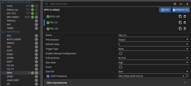

I am trying to set pin PR0_PRU0_GPIO6/K15 as digital output and make it toggle.
PIN 121(PR0_PRU0_GPIO10/G18) configured like this toggles without any problems:

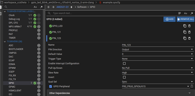

PIN 123 (PR0_PRU0_GPIO6/K15) configured like this does not toggle
I checked the generated pinmux configuration for both pins - the generated code both times writes PIN_MODE(7) to the pinmux which seems correct to me.
What am I doing wrong? Is there an additional peripheral i need to configure?

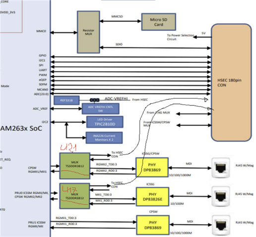

  • Found it out myself: the pins are connected to the ethernet phy and not to the HSEC connector:
    To be able to use the pins, I2C io-expander U50 needs to be configured, to write signal  ICSSM1_MUX_SEL high
    A software example for this can be found in
    mcu_plus_sdk_am263x_10_02_00_13/examples/drivers/gpmc/gpmc_psram_io/am263x-cc
