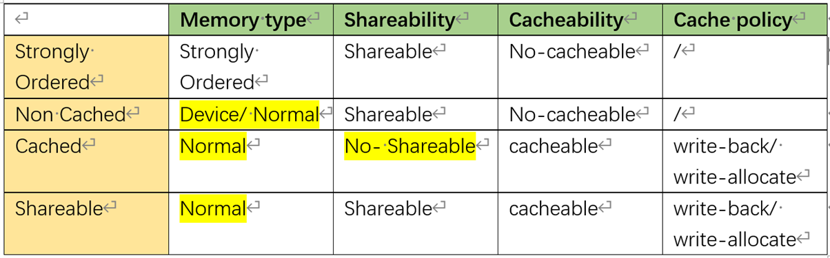

In the syscfg configuration of AM263P4, are the Region Attributes configurations limited to only certain combinations, rather than all possible combinations of Memory type, Shareability, Cacheability, and Cache policy?
I would like to confirm whether my understanding of the Region Attributes combinations provided in syscfg is correct, particularly the highlighted entries.?

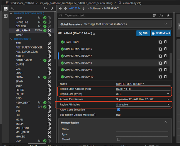

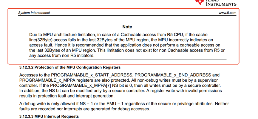

According to the TRM manual, the last 32 bytes of every 512KB must be configured as non-cached. However, in the fastboot example, this region is set to shareable. Isn't shareable equivalent to cached + shareable?
Question 3:
    Let me discuss this implementation in the SDK with the team and get back on why is this the case.
    I have summarized in the table below:
    No, configuring an MPU region as shareable does not automatically make it cached. Shareability and cacheability are independent attributes that can be configured separately. As above table shows, a region can be sharable and non-cachable.
    BUT, looking at the ti_dpl_config,c auto-generated code, I observe that when marked as Shared, the region also gets marked as "Cachable". I'll let the team know about this bug (jira.itg.ti.com/.../MCUSDK-14961)

  • Thank you for your reply! I still have a few questions regarding your response:
    Question 1:
    According to the introduction in the ARMv7-M Architecture Reference Manual link, I revisited the combinations of Memory type, Shareability, Cacheability, and Cache policy. The second column in my summary shows the preset options provided by TI's syscfg. Is my understanding correct?
    So, if I set a memory region as Shareable in TI's SysConfig, does it necessarily imply that it is also Cacheable?If I wish to use a non-preset configuration, must I use the method shown below? Is there corresponding documentation explaining the meaning of each parameter?
    Based on this, shouldn't the correct approach for Question 2 be to set the last 32 bytes of each 512KB segment as Non-Cached instead of Shareable? Regarding Question 3, is it indeed necessary to use functions like CacheP_wb for data synchronization? Furthermore, for the latter part of Question 3, why can the HSM firmware still read data from Flash and load it into the HSM's M4 core when the memory is configured as Cached (i.e., Non-Shareable)? I thought the Shareable attribute is required to allow multiple cores to share data?

  • Hi
    Yes, the presets are Strongly ordered, Cached, Non-Cached, Sharable. I've shared the default behavior of all the presets below:
    Strongly ordered:
    Cacheable:
    Non-Cacheable:
    Sharable:
    You can infer the exact config from the ARM Table screenshot attached below.
    If some other config is needed, you can select the advanced config and set it as per your requirements. Please make sure you follow the below table from ARM for correct configurations. Configure the C, B, S and the TEX bits appropriately.
    Shaunak
  • So, if I set a memory region as Shareable in TI's SysConfig, does it necessarily imply that it is also Cacheable?
    When the "Shareable" preset is used, the Syscfg marks it as cacheable

    The MPU does not act as a guard against memory. We are marking the region as cached and non shareable in R5's MPU configuration, this will not prevent the region from being inaccessible by M4 core.
    Also please note that the HSM FW does not read directly from flash. The R5 always reads from flash and stores in its RAM. In case of fast boot, there is a parallelization of application authentication that is being done. This parallelization happens between copy of app image from flash to ram by R5 core and its authentication by HSM core.
    Please check this app note for understanding on faster boot: https://www.ti.com/lit/ab/spradm8/spradm8.pdf?ts=1759215348745&ref_url=https%253A%252F%252Fwww.ti.com%252Fproduct%252FAM263P4
    When a region is marked as cached and shared, it means that cache coherency is maintained. If data is only copied from flash to ram and no update(write) of data is done in the marked area, it should be okay even if shared is not enabled.

    My actual question is regarding the routine where FastBoot configures the RAM region as Cached.
    In TI's SysConfig, "Cached" is equivalent to "Cached + Non-shareable"—these two attributes are bound together. Theoretically, they shouldn't be mutually bound.
    In the FastBoot routine, the HSM firmware is relocated from Flash to RAM. After verification, the R5 core and M4 core perform IPC communication to transfer the HSM firmware to the M4 core. Based on your explanation, since this involves inter-core communication, it should be configured as Shareable. So why does this routine still function correctly?
    Additionally, according to the TRM, the last 32 bytes of every 512KB RAM block in the AM263P4 need to be configured as Non-cached. However, in the latest SBL (Secondary Bootloader) routine, these specific regions are still set as Shared (which in TI's SysConfig implies Shared + Cached, as they are bound). Is this an error? Also, why do routines like the "Hello World" example not specifically configure MPU for these regions? Is it unnecessary?
    Once again, thank you very much for your help!
  • Hi Mingzhe dai,
    The question is valid. In this usecase, eventhough RAM is kept as cached, We are doing cache writeback invalidate before HSM related Transactions. So cache coherencey is maintained.
    The exmaple does not use entire ram area. That is why this is not explicitly configured.
