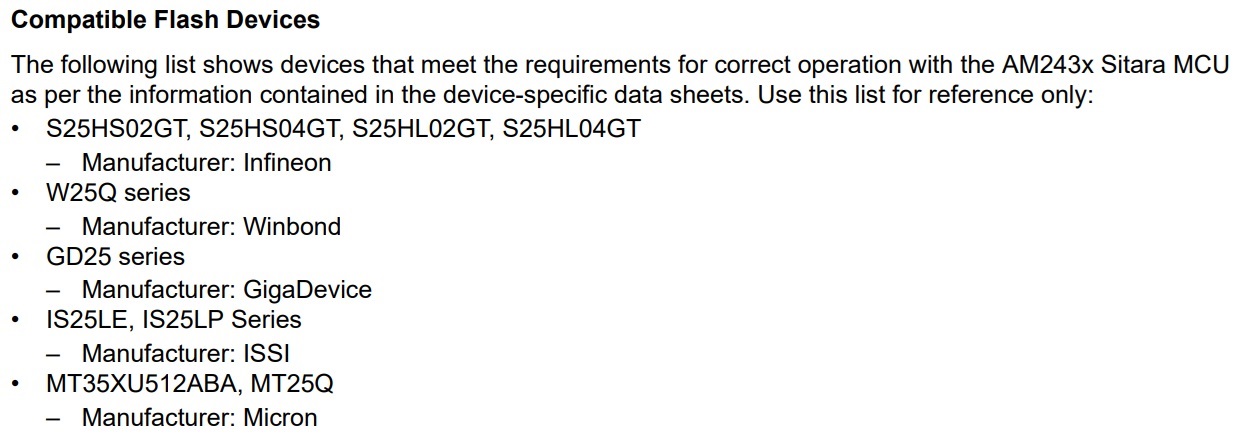

As for memory, it has been confirmed that it is a compatible series from the selection guide.
https://www.ti.com/jp/lit/po/sprt764a/sprt764a.pdf?ts=1756435212591&ref_url=https%253A%252F%252Fwww.ti.com%252Fproduct%252Fja-jp%252FAM2434

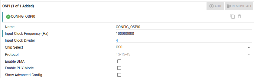

    For OSPI FLASH IO, the modifications that needs to be made is as following:

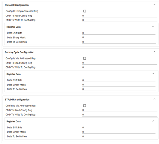

    1. In SysConfig of the application, have the OSPI settings as:

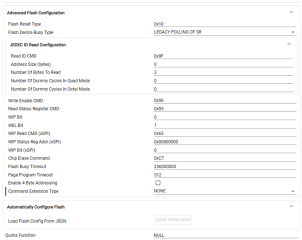

    2. In SysConfig of the application, have the FLASH settings as:

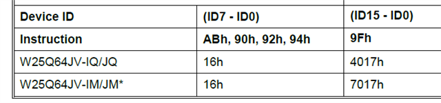

      NOTE: Set JEDEC Device ID according to the part number as mentioned in the flash datasheet(It will be either 0x4017 or 0x7017)

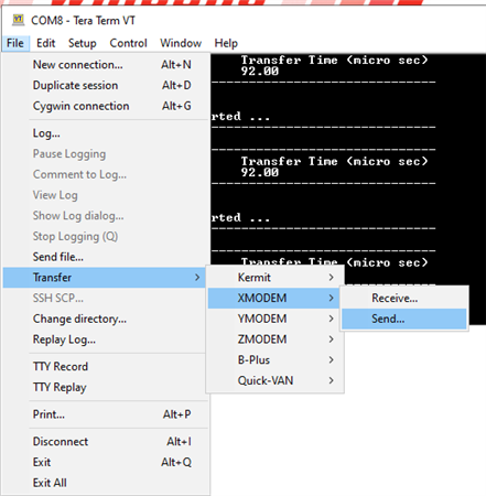

      1. Download tera term software.
      2. Open the tera term software and open the COM PORT X of UART for AM243.
      3. Set the board in UART Boot mode.
      4. Send the SBL NULL Release HS FS file in the following manner [In order to know if HS FS or GP Images needs to be flashed, please check the device type by reading through this: https://e2e.ti.com/support/processors-group/processors/f/processors-forum/1228618/faq-am6xx-how-to-check-if-device-type-is-hs-se-hs-fs-or-gp ]
        NOTE: If you do not see the SBL NULL Logs on the UART COM Port in one go, you need to send again as this overcomes a errata of warm reset. So basically, send the same SBL NULL Release HS FS file twice one after another(if in one go you do not see the SBL NULL logs on the UART COM Port).
