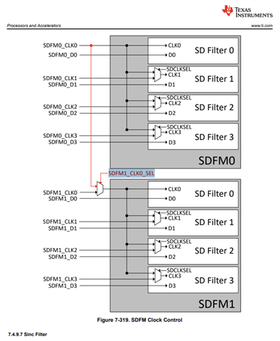

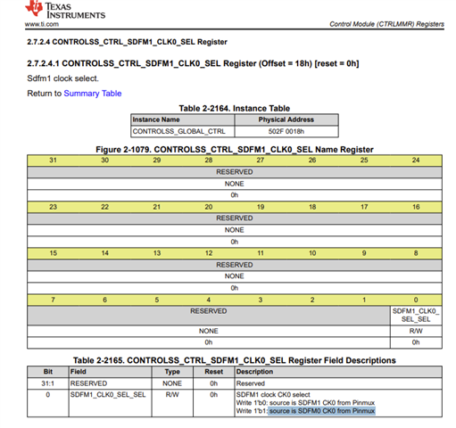

What is the best way to set CONTROLSS_CTRL_SDFM1_CLK0_SEL to "source is SDFM0 CK0 from Pinmux"?
(from https://www.ti.com/lit/ug/spruj42e/spruj42e.pdf?ts=1756786931208 2.7.2.4 CONTROLSS_CTRL_SDFM1_CLK0_SEL Register)
(from TRM Figure 7-319. SDFM Clock Control)
I found SOC_selectSdfm1Clk0Source in the MCU sdk, but it seems to crash the application when i call it after:
System_init();
Board_init();
Drivers_open();
Board_driversOpen();
https://github.com/TexasInstruments/mcupsdk-core/blob/85477ff8c96d871fdd94772fcc2d4a6416049841/source/drivers/soc/am263x/soc.c#L417-L429
Is there a best time to call this?
  • Little more color, there does not seem to be a syscfg setting for this mux, so I am trying to set it in software.
    Is there a setting in syscfg that sets this mux so the sdfm1 clk source is that of sdfm0 clk input?
    If not, every time I call SOC_selectSdfm1Clk0Source(1), it crashes the program, regardless of where I call it in the configuration. It may have something to do with the unlocking and locking of CONTROLSS_CTRL. Removing the unlock/lock function calls does not change the behavior - still crashes.
    Any help is appreciated. Thanks!
