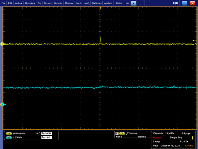

  • Hello.
    As per your advice, I performed pre-charging of the capacitor using GPIO and checked the current and voltage. In Image 1, channel 1 shows current at 20mA/div and channel 2 shows voltage at 1V/div, with a 30ms charge. In Image 2, channel 1 shows current at 5mA/div and channel 2 shows voltage at 1V/div, with a 35ms charge. With 30ms of charging, the voltage is less than 1.4V and a current of about 12mA is flowing; however, with 35ms of charging, a reverse current of 10mA occurred.
    • According to your explanation, you mentioned that there is no problem even if reverse current flows, so is it safe to precharge for 35ms without causing any damage?
    • I think that bringing the voltage closer to Vref will further reduce the current, but to what level (in mA) should the current be lowered to ensure that no damage will occur?
    Since ERR_03 is talked about Vref module charge external circuit will cause damage.
    And ERR_02 means discharge to Vref module is slow.
    There is no mention that discharge will damage vref.
    35 ms is OK.
